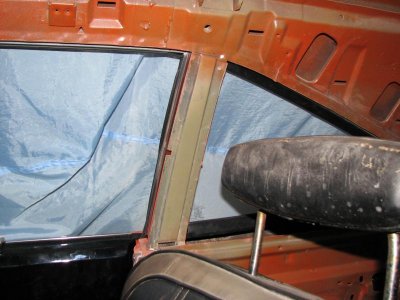

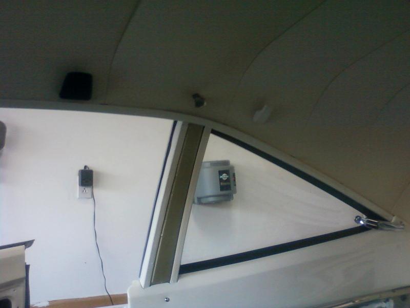

After searching long and hard, this is the only pic I could turn up. I was a little curious myself, because my RR is tore apart also at the moment and will start going back together early this summer. I don't have any good before pics of that part in particular. Also, if anyone could chime in on if that center part should be body color, upper door frame color, or interior color. I would greatly appreciate it. Sorry, to borrow your thread, but thought it could be useful for you too. This is not my car by the way.
i went out and looked and i see what you mean.i assume its the same as the inside door paint.

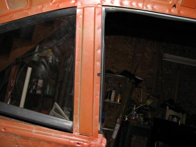

After searching long and hard, this is the only pic I could turn up. I was a little curious myself, because my RR is tore apart also at the moment and will start going back together early this summer. I don't have any good before pics of that part in particular. Also, if anyone could chime in on if that center part should be body color, upper door frame color, or interior color. I would greatly appreciate it. Sorry, to borrow your thread, but thought it could be useful for you too. This is not my car by the way. thanx for your help plum.im gona post a pic of mine. thanx randy
thanx
That is what I thought too, but for some reason after sanding down several layers of paint that were on it, I want to say I found the original color body paint on it. Not sure if it started as the body paint color and then at some point of the manufacturing process it is painted over originally. I could be remembering wrong though. That is why I was a little curious.
inside post pics 70rr
IMG_1985.jpgIMG_1986.jpgIMG_1920.jpgim gonna go with gloss black?

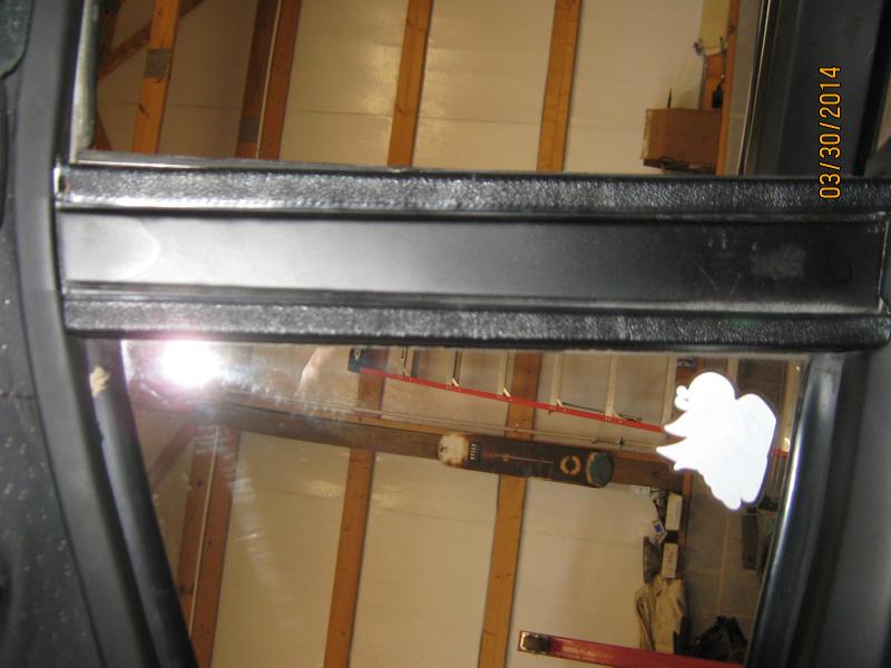

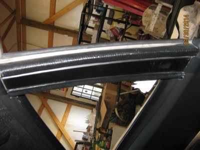

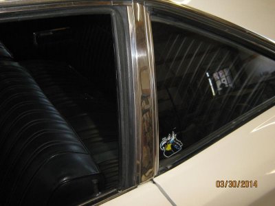

Randy , I went out to the shop and took a few pictures of my bee. I hope they help you see what you need. BTW you need to clean out your PM box. Matt
