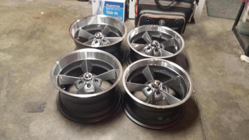

I'm going to have to be critical about axle width now. My intention was to order wheels after I get the axle sorted, but these just fell in my lap. Guess I'm going to have to do it the right way. LOL
