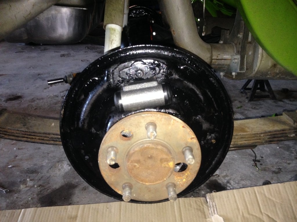

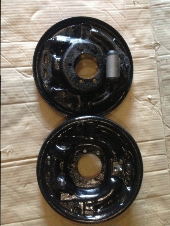

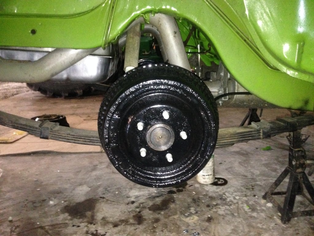

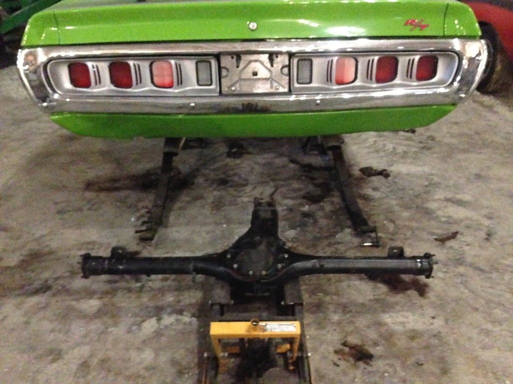

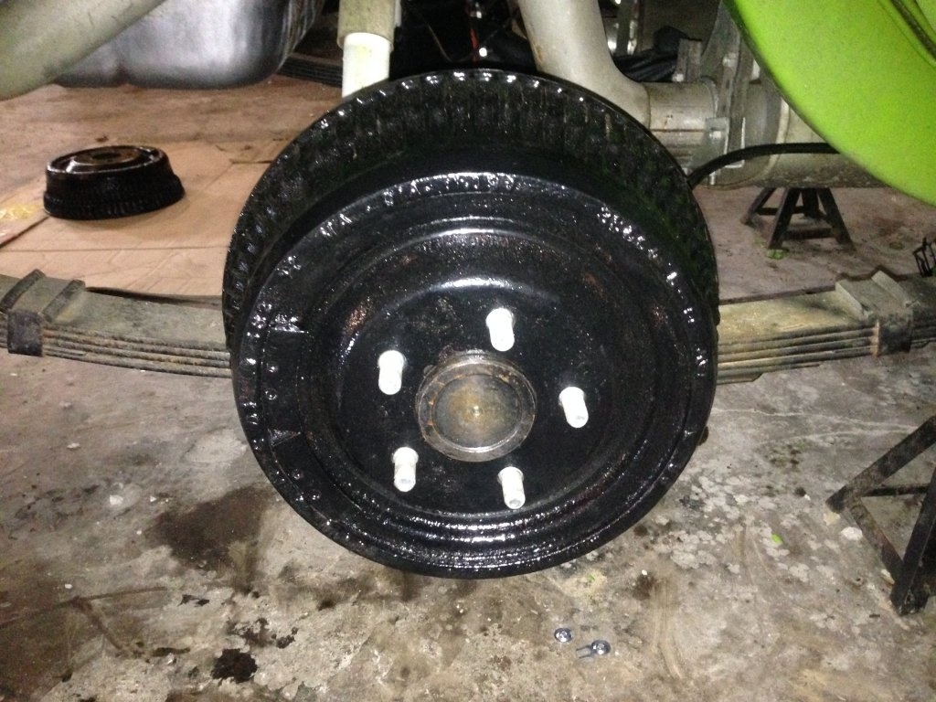

A lot of my pictures were lost in a computer issue, but the first thing I did after reacquiring, was to swap the 3.23's for 3.91's with a locker and some 11" brakes donated by a 74 charger, RIP. New wheel cylinders and hardware finished it out, but I still need to install one new brake line.

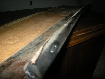

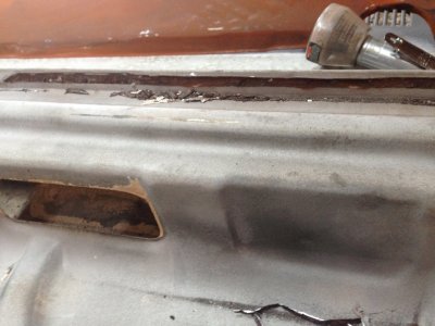

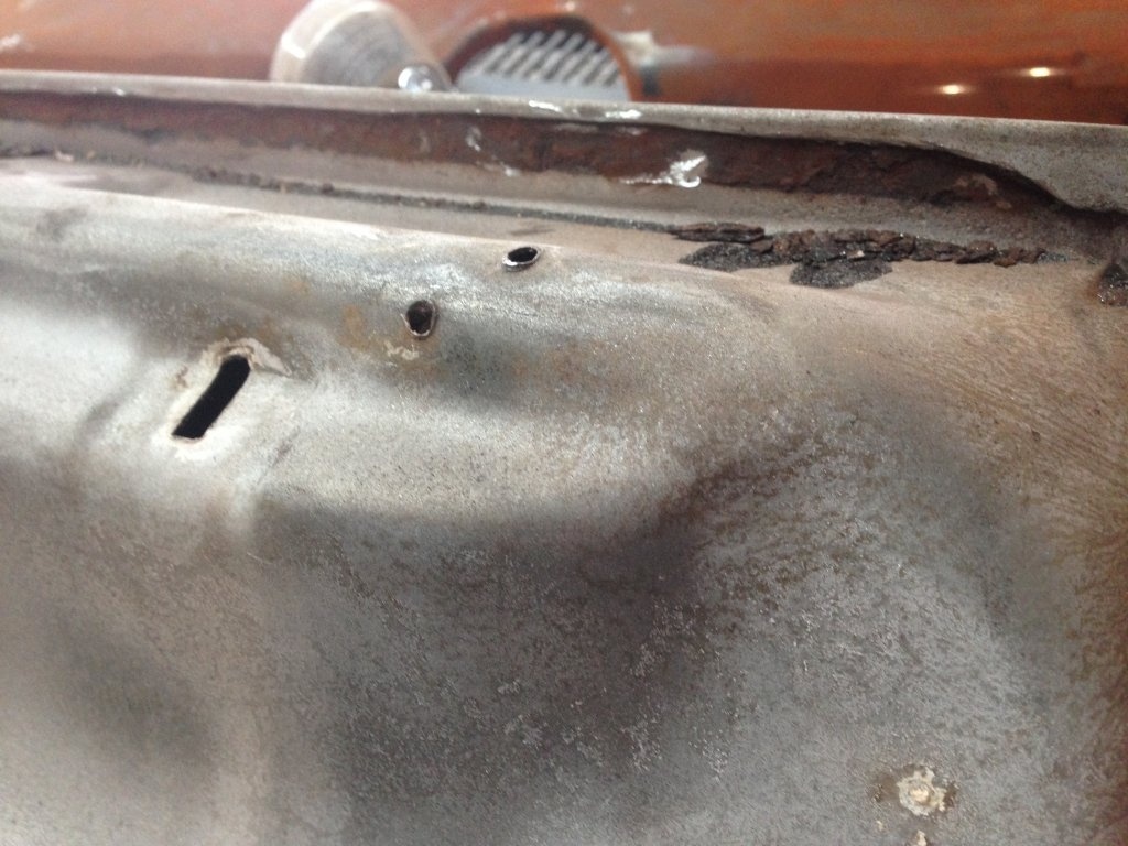

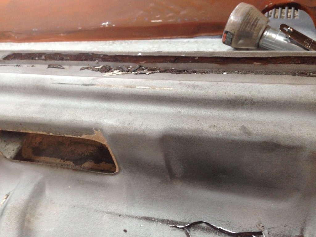

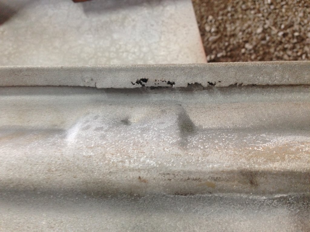

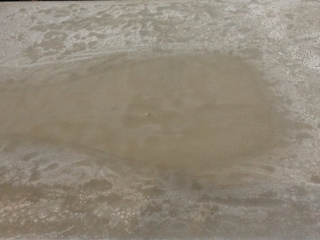

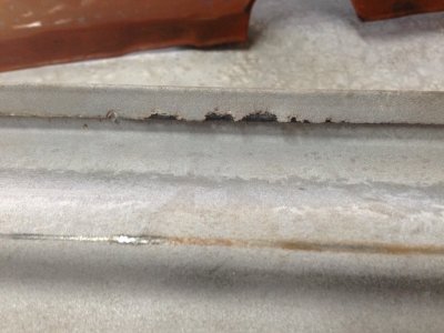

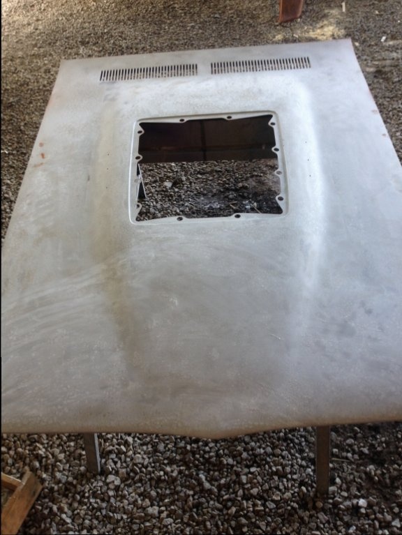

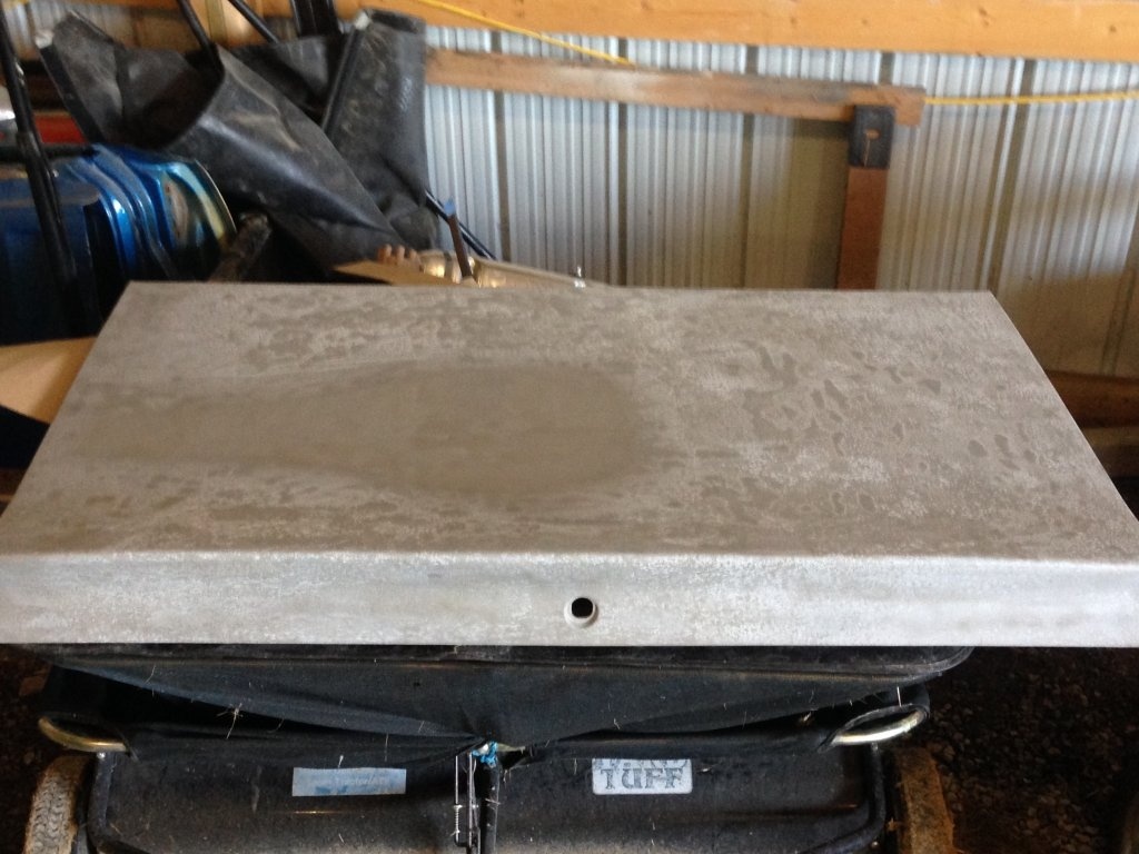

Here the hood after I just got it back from the blaster . It is solid with some minor pitting under where the decal was but other than a couple cracks in the inner structure, just needs some smoothing. The trunk lid was donated by that 74 Charger and came back with one ding and a couple problem areas on the inside lip. I cut these out last night, but what is the next best step on this besides clean, treat and seal?
Three opinions have been given to me, leave it as is because its on the inside and this isn't a show car. Weld a tiny strip in for aesthetics and finish, or the guy I was planning to have paint it, wanted to cut it out all the way to the front and weld in a new lip that folded over the edge. I shied away from that, and from him at this point, as the rest of the trunk lid is rust free.

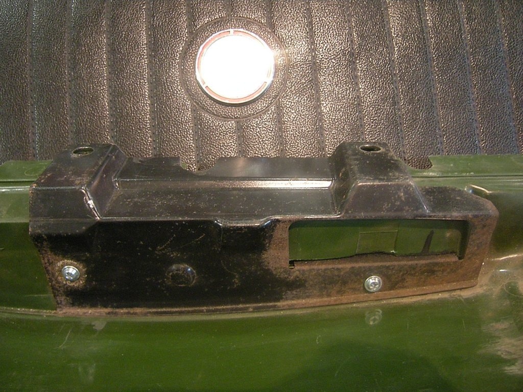

IMG_0475.JPG View attachment 342172 IMG_0478.JPG IMG_0479.JPG IMG_0480.JPG IMG_0481.JPG IMG_0482.JPG IMG_0483.JPG

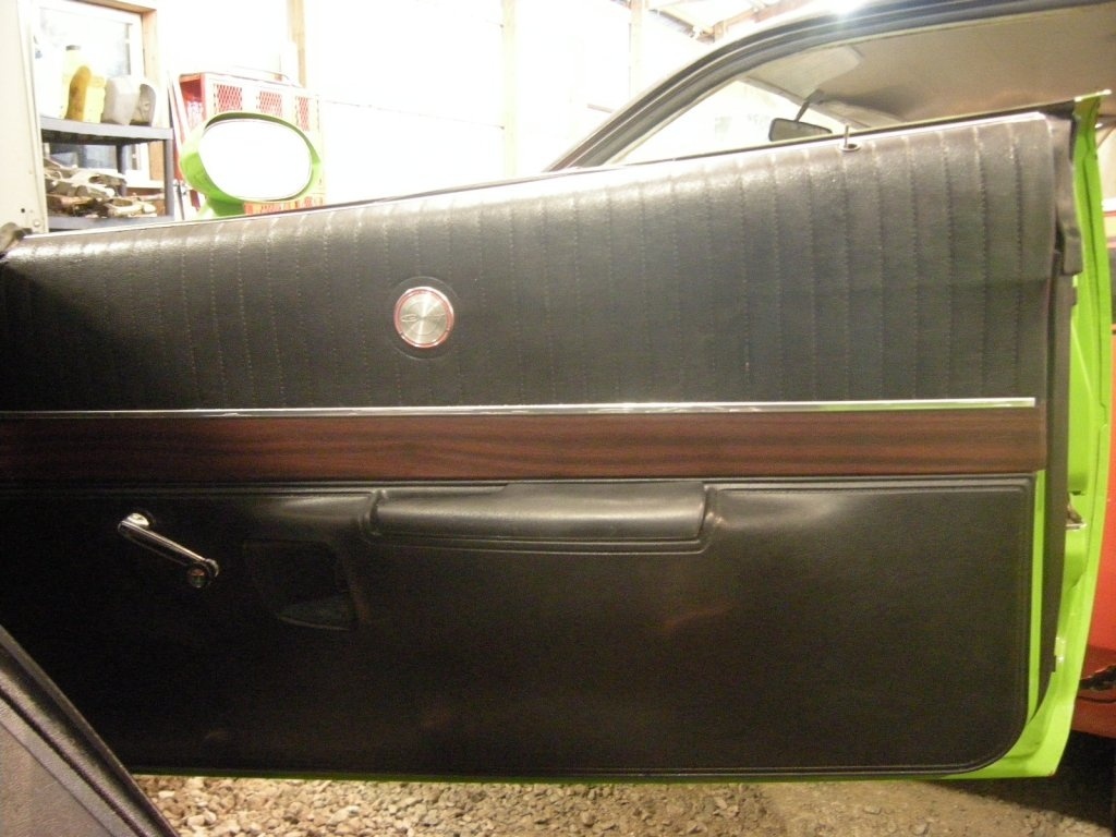

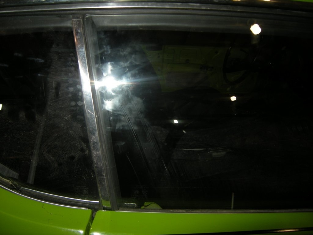

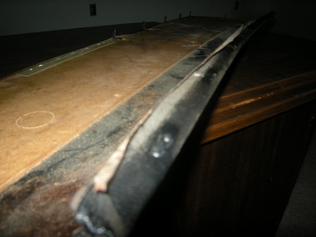

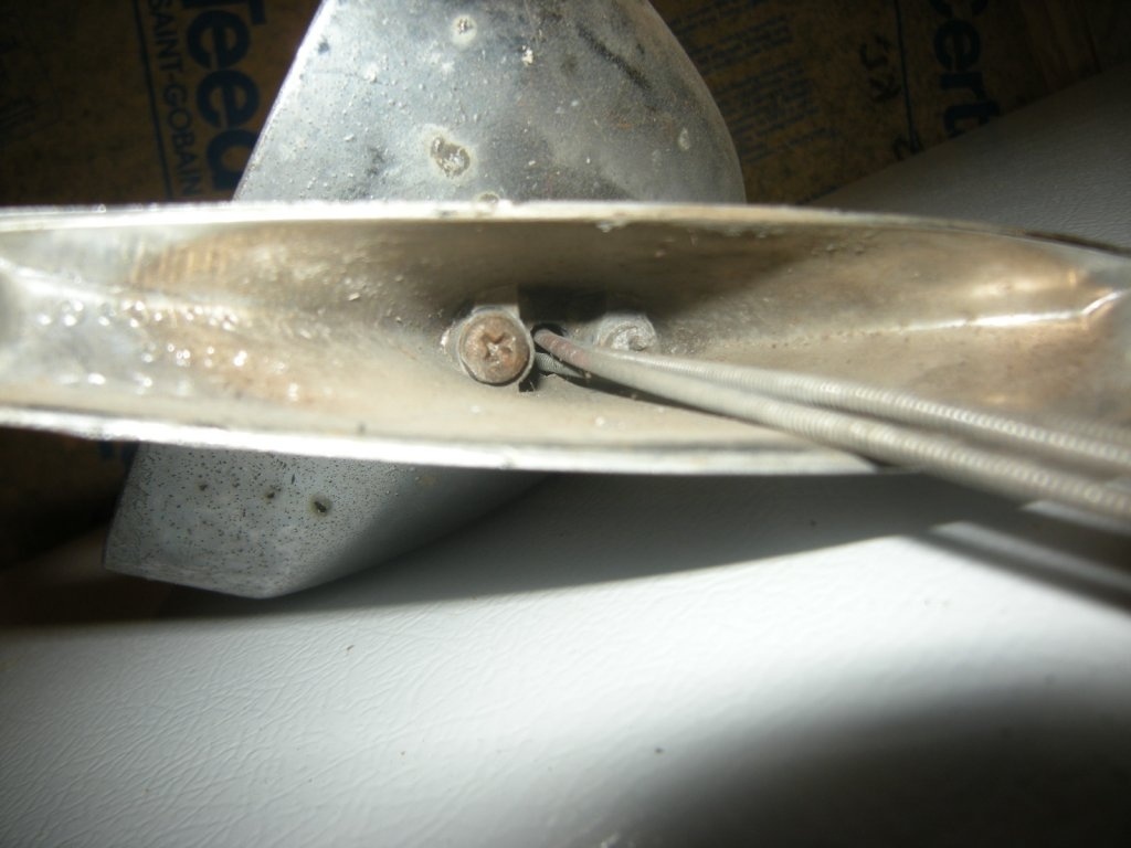

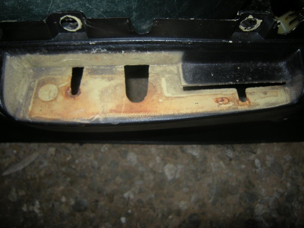

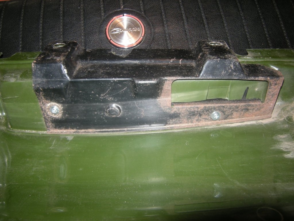

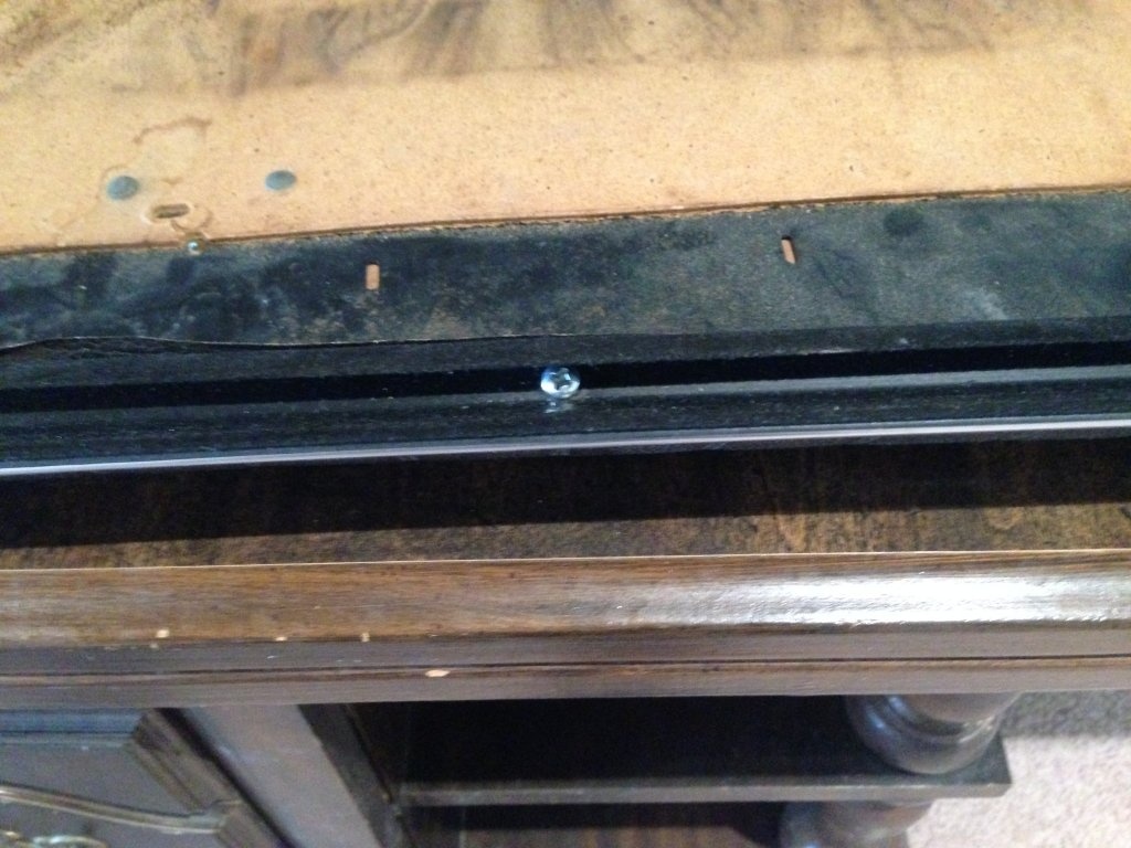

The metal work will have to wait until next week, so I worked on some of the interior pieces. I installed new window felts on the upper door panels. The originals were stapled and I guess I should have done more homework because everything I have read now, said to buy the "Cat Whiskers" brand, but I just bought some from the same place I ordered the carpet. These are not made exactly like the originals and I used small self tapping screws as there were predrilled holes in them. The look and fit like the originals, but are made different.
DSCN8369.JPG DSCN8370.JPG DSCN8371.JPG View attachment 342929 IMG_0487.JPG IMG_0486.JPG DSCN8393.JPG DSCN8394.JPG

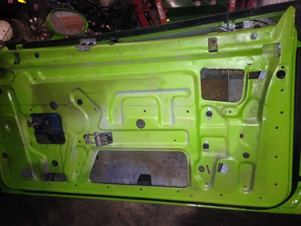

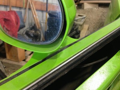

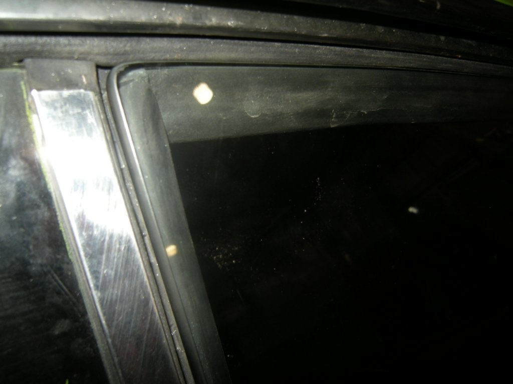

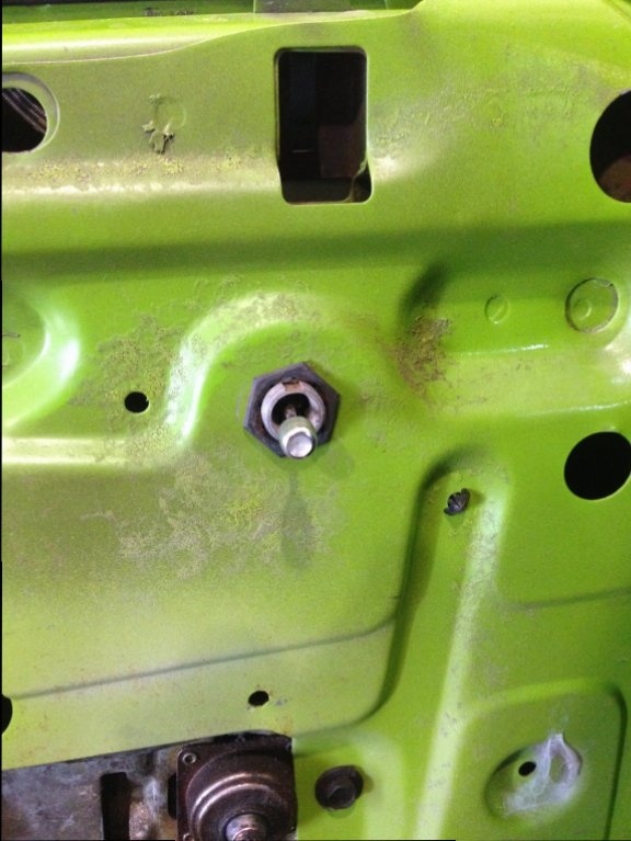

Before I buttoned up the passenger side, I had to do some investigating on the window as it did not roll up correctly. It turned out that the rear guide for the lower roller on the scissor was installed upside down. Talk about a waste of 2 hours. I finally got the window to close properly and the new weatherstripping looks like it will seal well.

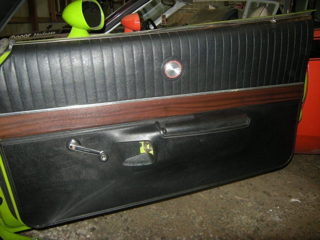

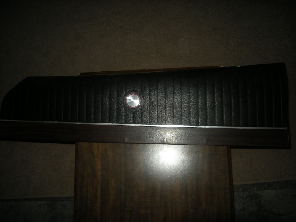

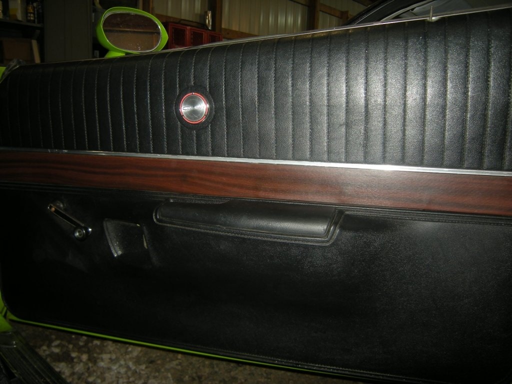

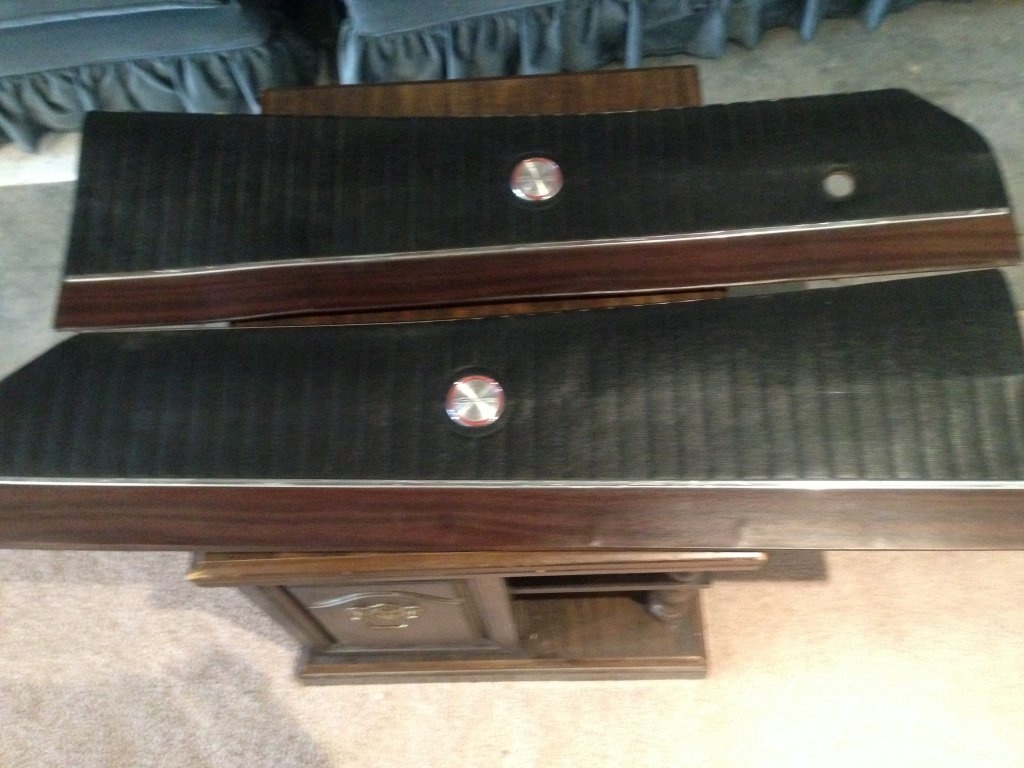

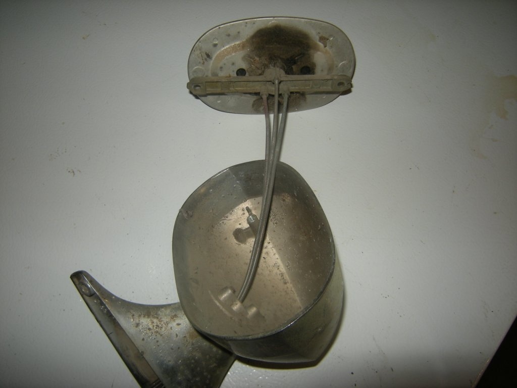

The driver's side is going to have to wait a bit because, even though these are original R/T upper door panels, they are not from this car, so they have a hole for a remote mirror which this car does not have at the moment. I took a spare remote mirror apart but still have to swap the internals with the painted mirror that is on the car.

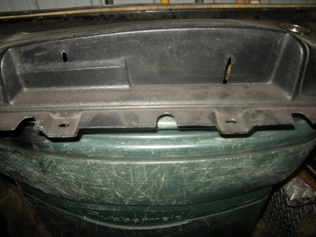

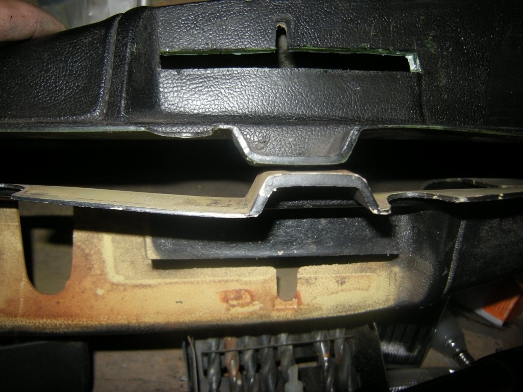

I dyed some lower door panels from that 74 charger to replace the painted gold ones that were in the car as they were chalky. I did not realize the difference in the metal reinforcing bracket until I had the panels off, but the 74's were easily modified to accommodate them with a utility knife.
DSCN8360.JPG DSCN8361.JPG DSCN8365.JPG DSCN8366.JPG DSCN8367.JPG DSCN8378.JPG DSCN8379.JPG DSCN8380.JPG DSCN8368.JPG IMG_0224.JPG

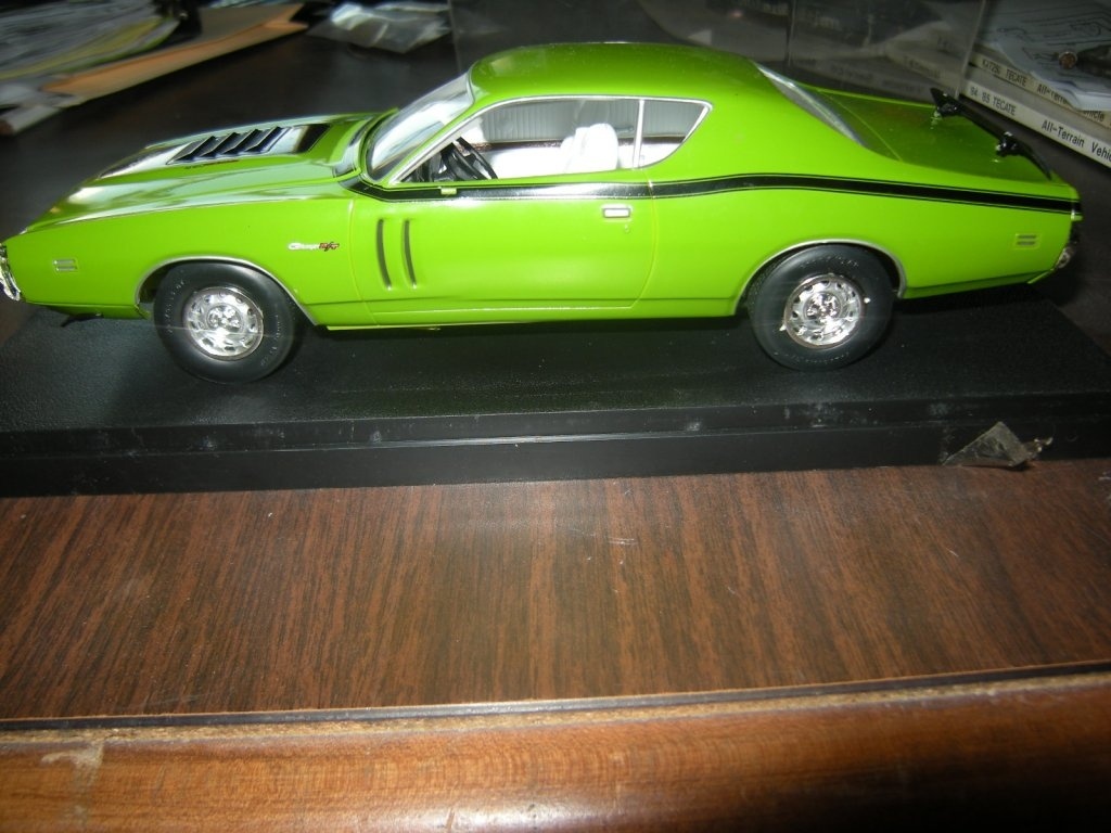

What scale is that model rt? Wants sell it? It would look good next to my purple one
All the mopars are 1:18 the older cars are 1:24 that fastback Buick was quite a fight to get cost a little under $300 to get it people are going crazy for them for some reason I've seen the in the $900 range .
Sorry nstyle73 don't mean to Jack your post Zach was interested in the scale size .
The OP's model is 1/25 and can be had pre-assembled as a numbered edition.
They do a really good job, complete with air cleaner pie tin decal, heater hoses, etc.
I've got one and an unassembled one to use as a donor for my 73 RR kit which has an incorrect and poorly detailed firewall.

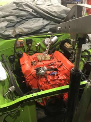

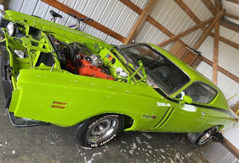

A long road it has become. The hood and trunk lid are finally at another shop to be painted after several issues. The engine is a 73 steel crank motor from a donor car that runs quite strong for no notable performance updates. I put a new ready-to-run distributor in, 14 degrees of initial timing and it fired right up. Moved it into the shop and gave it a bath.

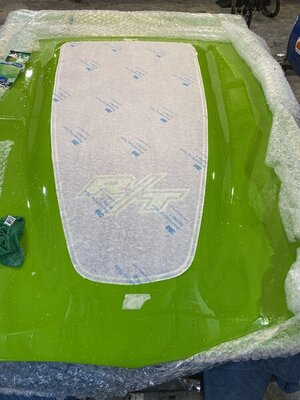

First time installing such a large decal. No significant issues but it could be nitpicked. The decal is shorter than the one I took measurements from and was solid so the insert had to be cut out afterwards so that created a bit of a sag that had to be worked out.
