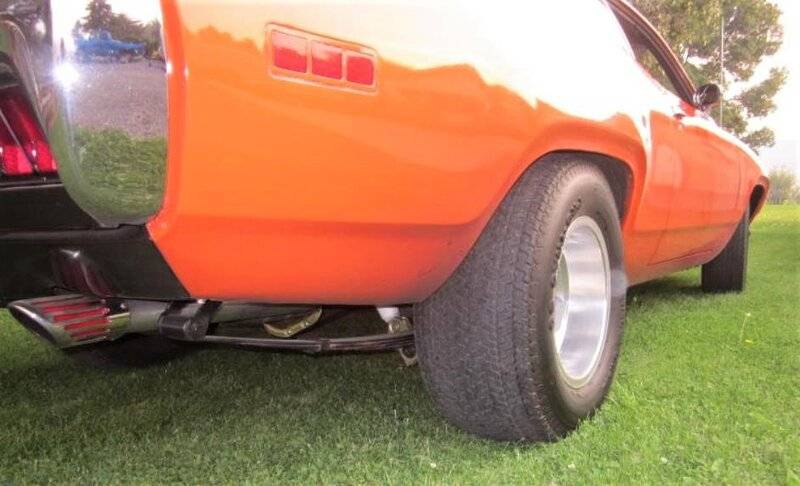

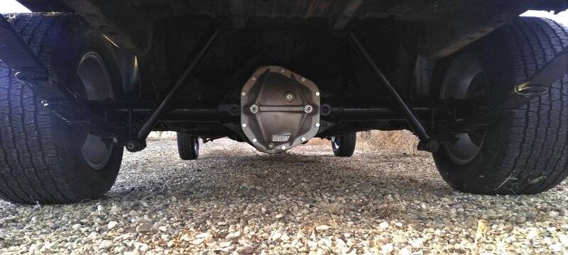

I have a pair of 315 street radial pro's. That is a LOT of tire to get under anything with stock leaf location and tubs. Frankly, I bet they don't fit.
28" tall N50's on 15X11 wheels 3.75" backspace with a '69 B body Dana, offset spring hangers/shackles with stock wheelwells.

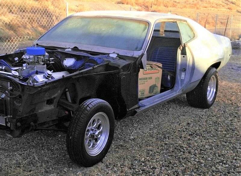

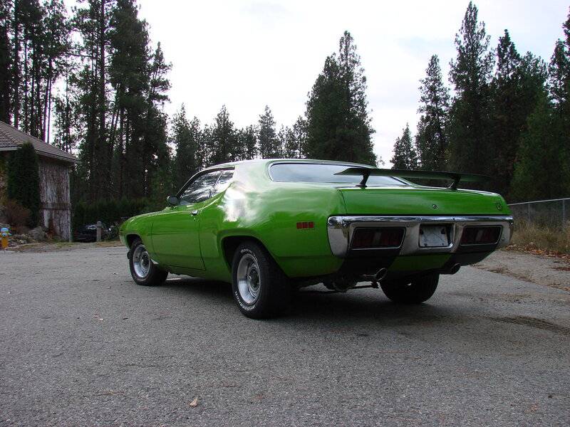

295/50 X 15 on 15 X10, 5.5" backspace, offset springs, stock '71 width rearend, stock wheelwells.
