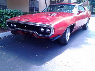

Sorry, no **** available yet. The car is two hours away. I am heading down there Thursday to star stripping the car. Here is the car we are redoing though. image.jpg
