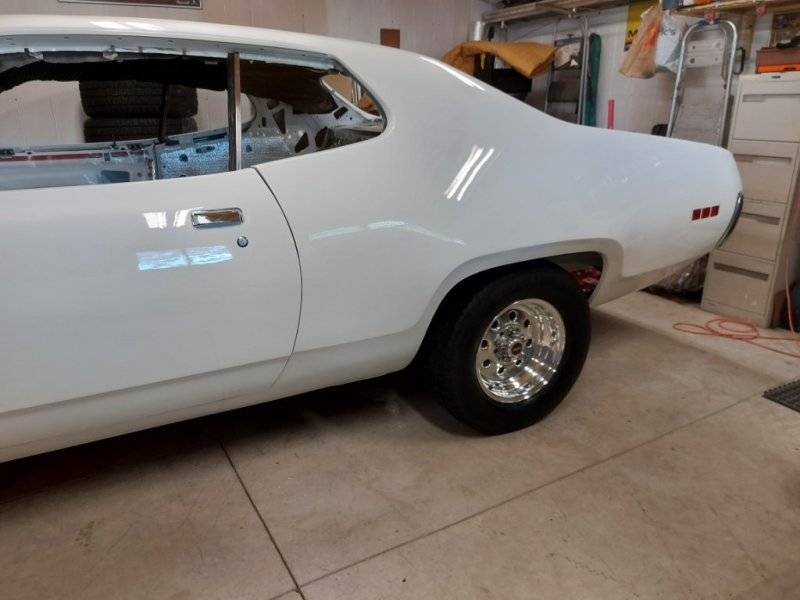

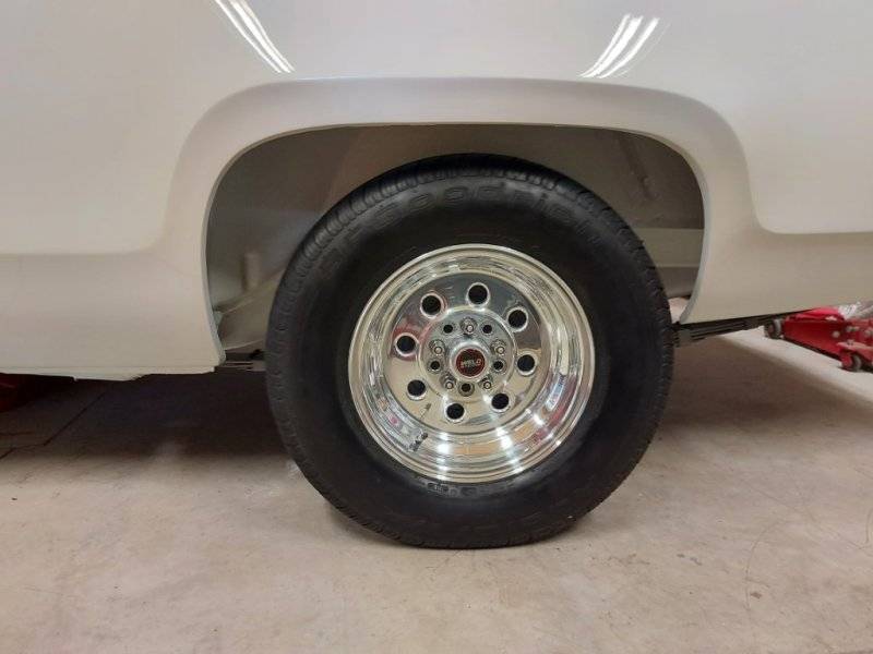

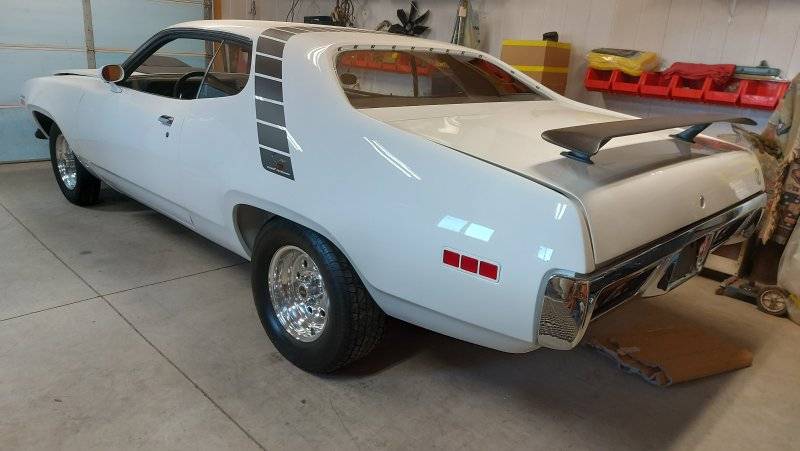

You should be okay with a 10" rim.
I have 15x8's on my 71 Runner.
BUT I also have the 1.5" offset leaf spring set-up on the car.
The tire is a 275-60-15.
