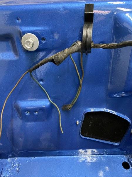

Recently picked up a 71 RR 340 4 speed. The car was missing the beep beep horn, however it did have a standard large-washered bolt in the upper horn mount on the inner firewall. I ordered a horn for a 71 to 79 RR and received it yesterday but it does not seem correct for this application. The mounting bracket seems too short for the large washer and it is threaded which won't work with the also threaded firewall mounting point.

Since my car is an early build date, 10/13/70, is it possible I need to order the 69 - 70 horn instead?
I called Classic Industries but they couldn't offer any advice or suggestions. I guess I can drill out the threads on the horn and mount it on the inner fenderwell with a bolt that has a smaller washer. It just doesn't seem right to have to modify the horn if it's supposed to be an accurate reproduction, especially when it cost nearly $100.
71's use the long bracket like 70's so many resellers advertise this wrong.

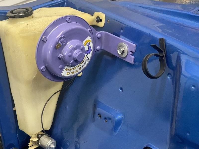

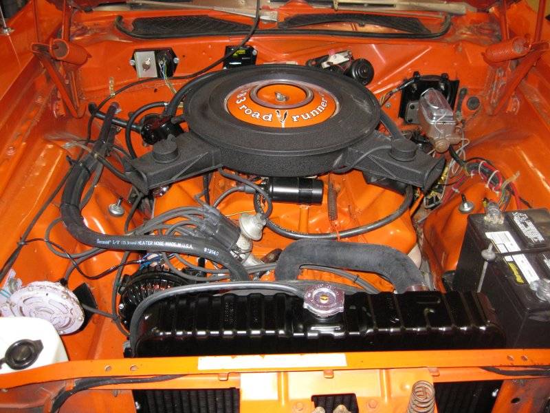

I think I now have the right horn but it looks upside down. I could clock it 180 degrees but then I will have unpainted parts and it also won't look right. Mopar Jack's horn looks right on but how do I make that happen without re-clocking and repainting the whole thing?
My horn was clocked like yours and it never made sense to have the decal upside down so when this post came up it pushed me to make a change. Since I had restored this original horn with correct tube rivets and paint I was able to clock it and touch up the paint.
