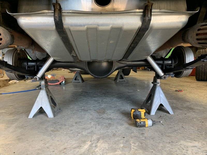

Been a while since I posted updates and did any serious work. Anyways.. Got the 440 in last weekend, 4 speed and all. Spending today getting the z bar and clutch linkage hooked up. The flanged section of the gear vendors tail shaft is hitting the tunnel but that’s a job for the lift. Also painted the 8 3/4, installed new rear shocks, and threw in a new fuel tank and sending unit. Inching a little closer.
