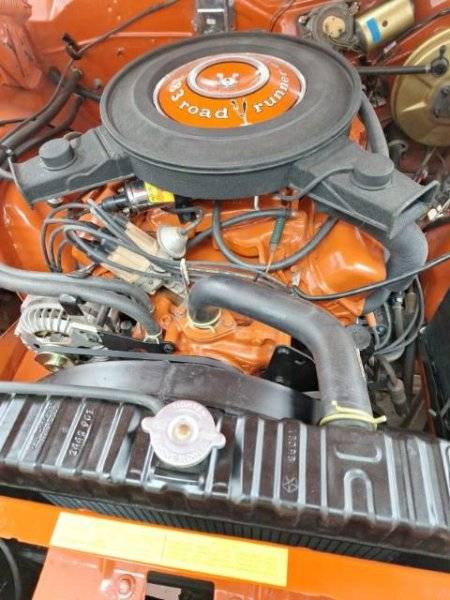

Okay, well mine does seem to be there and in fair working condition, worked flawlessly yesterday. Perhaps it just needs some time to work back in, I'm sure the car had been sitting an easy 20-30 years before I rescued it, pics attached. As of yesterday, the car is almost back to 100%. I have just two last remaining issues, the tach won't work and the hood turn signals won't work. Not originally a tach car but someone had already installed a tach cluster in it, just had no wiring to it. It now has the correct wiring running thru slot #20 in the bulkhead connector as instructed, but hasn't moved. Being run thru the bulkhead connector, is it not supposed to tie into the fuse panel somehow? Hood signals are also brand new and simply don't work. One of the originals did work before I restored the car. I assume these ground thru their connection to the hood, yes? Could it just be too much paint between the two? I did scrape off a little to see if it helped, no go.

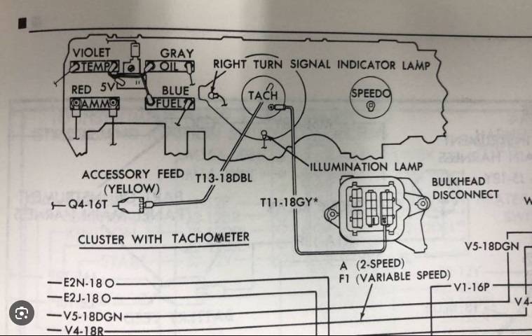

Okay, thank you for that. I did get the hood signals figured out yesterday and it was indeed too much paint between them and the hood metal for ground. Only thing left is the tach, it just simply doesn't work, power is plugged into yellow acc plug, ground goes thru bulkhead #20 and out to negative side of coil. What am I missing? Does it need to splice into the fuse panel perhaps?
Ok so you have at least that diagram which shows that the T11 wire (which is the signal wire) goes to cavity #20 on the BH and then out to the negative side of the coil. The other wire T13 is a "feed" wire and should go to a keyed 12V source, meaning that it is hot when the key is on.
First check for power on T13 which is a dark blue wire connected to a yellow accessory junction. I don't know if the tach requires a ground but I would assume it does and would get one through the instrument cluster in some way (I would have to and look at a cluster to be sure and I am sure someone here will chime in), but you could also try and connect a wire to it or even just touch it and ground the other end. The feed side is pretty straight forward but you might get a continuity tester and test all of the wires to make sure that they are in fact making contact.
If it is getting power, the ground isn't an issue and the feed wire is connected then the tach is broken.
