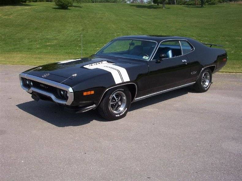

Have a question... why a RR clone and not GTX ?...
It seems to be a nice car to work with it
Honestly never thought about it. But I guess because this is the way the car came to me. And, I don't really know the difference between GTX and RR
I'm fine with RR though. Little more "believable" this way.

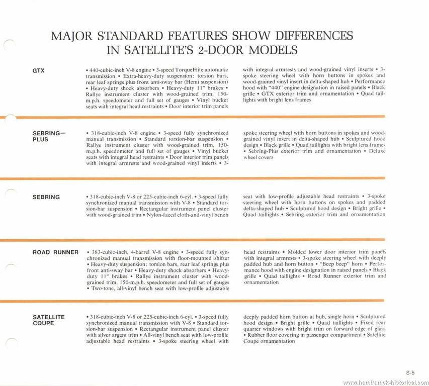

Man! Now that's an answer. :) excellent page. Thank you. This is the correct one for my car. How much should I offer for it?
Depends on what actually came with your car as per the VIN. I wouldn't "offer" nothing for it. Make your friend start with what he wants and go from there, making him start the bidding
Remember, i'm a faker. So my VIN doesn't matter at this point. But assuming it was a correct '71 RR, I'd like to have the correct goodies on board.
As for the price, i think he'll give me a fair shake, but i don't really know what "too much" would be on one in this condition. It'll need complete resto, and a new pie pan.
