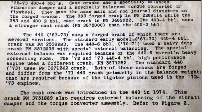

Did 72 440s come with cast cranks?. I know they went to cast cranks in 73 but wasn’t sure about 72s.
My 72 has a forged steel crank. Go to the 440 Source web page and check out the "Everything you ever wanted to know about the 440 engine".
From the '76 DC bible if it helps................

All 440’s I’ve seen have forged crankshafts thru 1973. The direct connection engine manual had a lot of wrong information in it. Motor home blocks, thin wall ‘76-‘78... other stuff I can’t remember. I passed on many late blocks because of that.

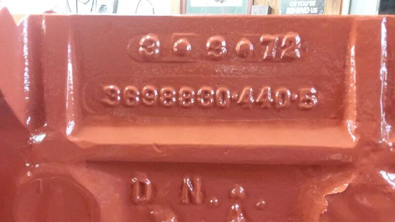

However.....even THEY get it wrong sometimes. My block is out of a 72 Charger. It's build date is 3/3/72 and the casting number is 3698830 which 440 Source says is a 1973 casting number. Can't be true, my block is clearly stamped 72 and came out of a 72 Charger, numbers matching original motor. lol.
