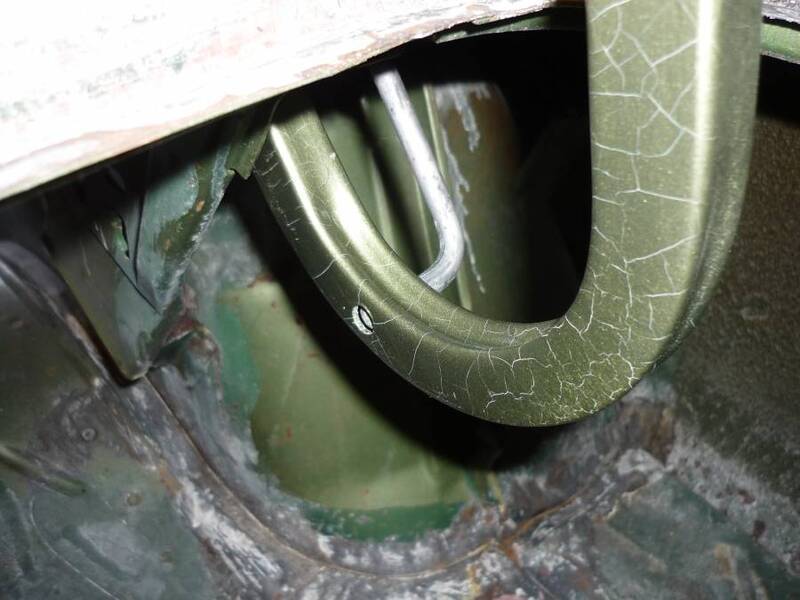

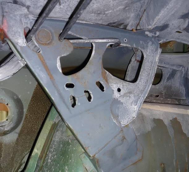

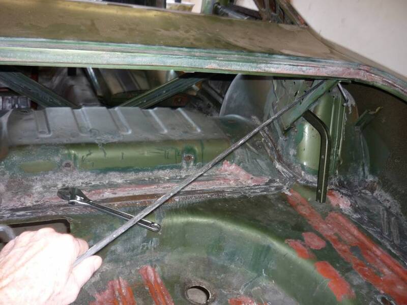

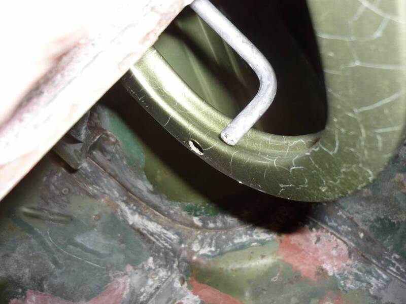

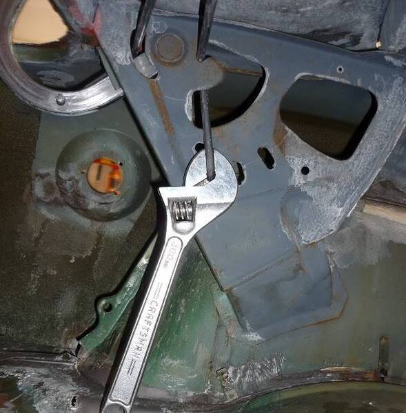

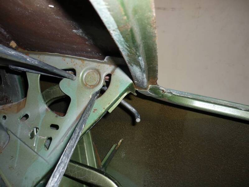

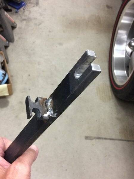

Anyone have information on how to reinstall the rear deck lid torsion rods that support the trunk? Mine were removed at AMD when the body panels were being replaced and were in the trunk. I have searched youtube and body service manuals with no information found.
Updated--courtesy kentj340 of moparts.com. This is A-body but it should be close. See my 72 Charger Below.
What are the complete installation views side to side? I need to know how and where to connect on both sides. I usually figure things out after careful study, but these have me stumped.

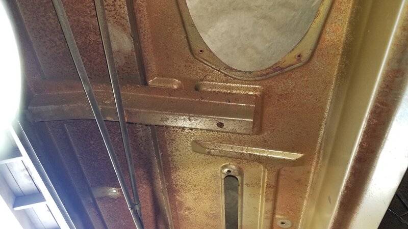

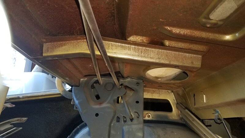

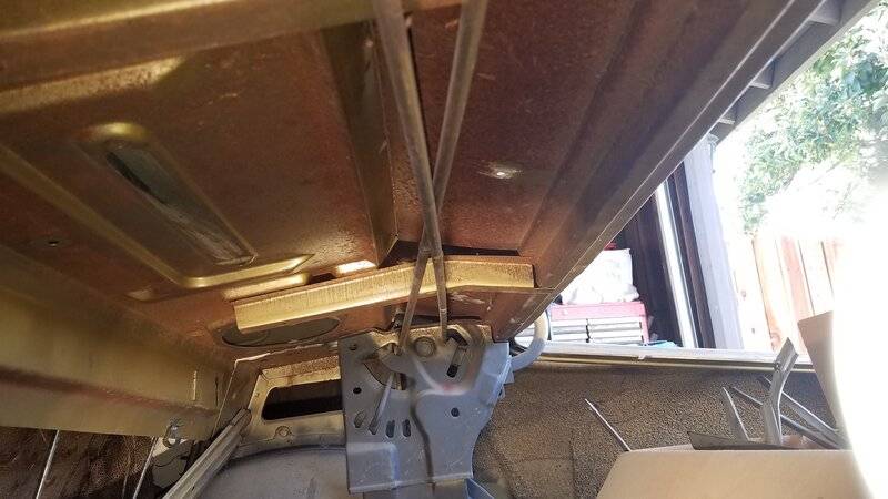

This help? One of the only unmolested areas of my car.
