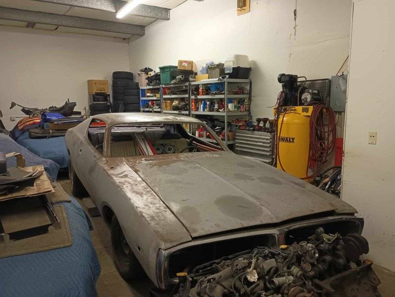

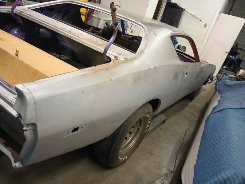

Shes very straight and solid. Just boring . When I went to look at it I expected a scalped out parts car, but shes all there for the most part. Title and VIN numbers are all square. I'm gonna offer him 4500 for starters. Too much? What you guys think??

From those angles, it appears straight and solid.
Got nothing to lose
