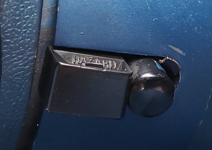

as an image reference to this reply:
I think on my car remains tuned on by 10-20 seconds depending on how long the doors were kept open, no that long like 1 or 2 minutes
For bulb service, is just about pull out the cap and will reach the bulb
( 70s and most of 71s require the steering wheel removal... diff design. Untill got changed to this later design along the 71 year )
