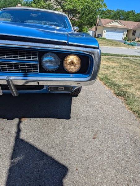

Hey purchased a headlight relay harness for my 72 Dodge Charger with hideaway headlights. After installing the harness the hideaway doors will only open and stay open. Headlights also stay on no matter what position headlight switch is in.
Could the OEM headlight or hideaway door relay be bad and causing the issue?
Appreciate any ideas!
Disclaimer: main reason for installing the harness is to keep main power from going into the headlight switch. Recently just replaced switch and plug due to burned up switch. Reached out to Cracked also to see if they had any ideas.
