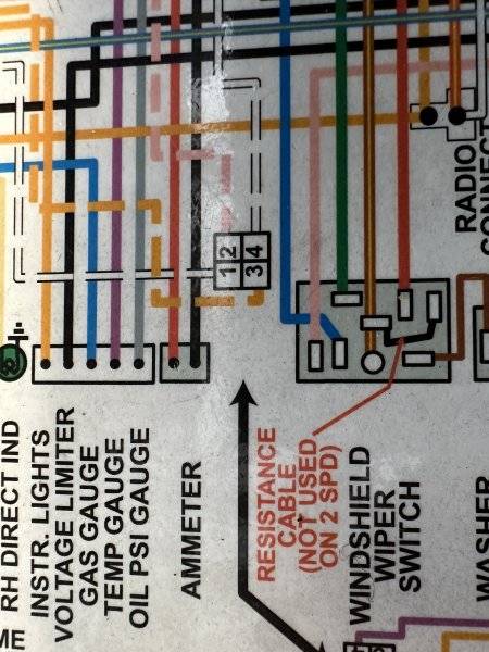

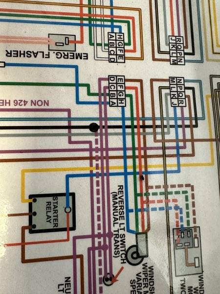

Looked at my diagram and concur with the consensus here. the one with tracer goes to variable speed wiper (at least on my super bee/coronet rt diagram). The trcer wire shows to be only on the dash side, not the engine side (E to E)Likely the same for the charger...
