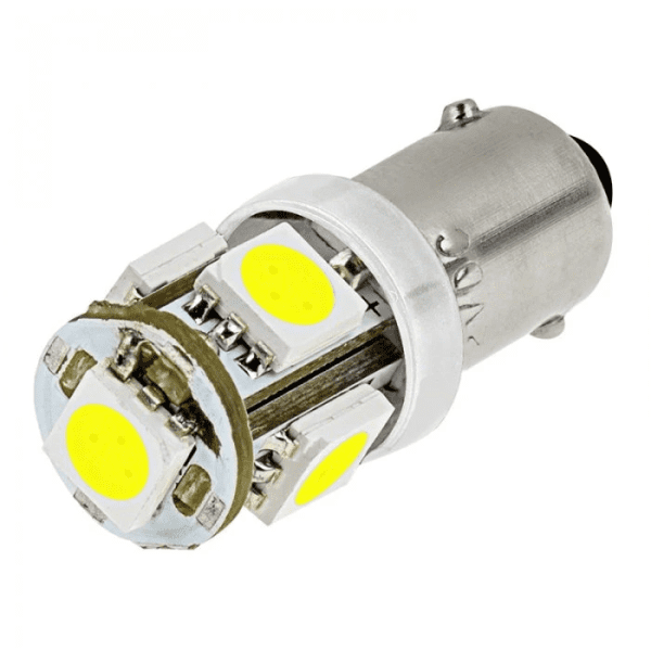

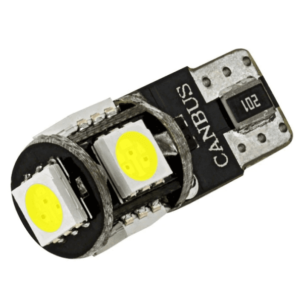

car is currently at shop, so i cant look for myself, how many led bulbs do i need to order ?
I know some are push pin style and some are regular.
does anyone know how many of each ?
None of them are push in, they are all push and turn in, like the first bulb you show.
At least they are on my 1971 Runner dash.

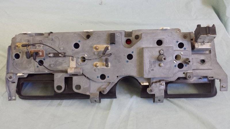

looks like 12 total including heat control ?
11 on cluster. 4 of them are pilot lights ( high beams, 2 turning, Brake ) rest are cluster illumination.
add 2 more if 71/72 heater/AC control
just one on 73/74 heater/AC control
all Rallye cluster lights use the bayonet kind socket BA9s
