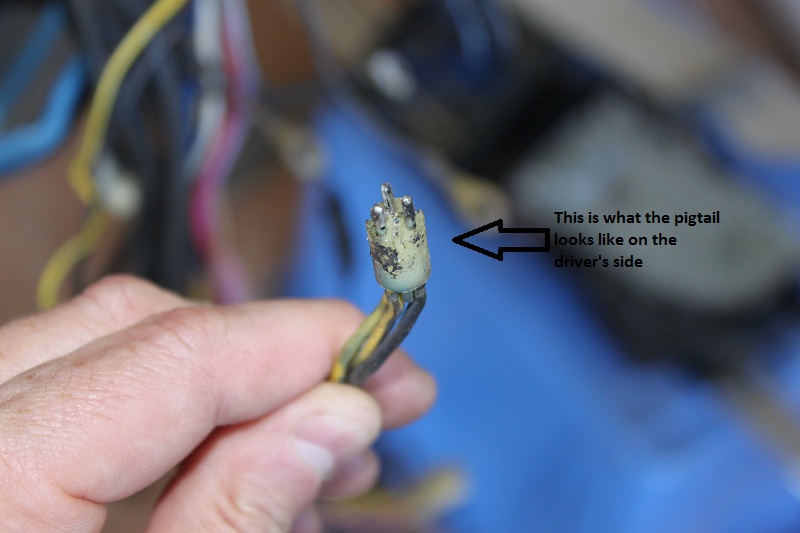

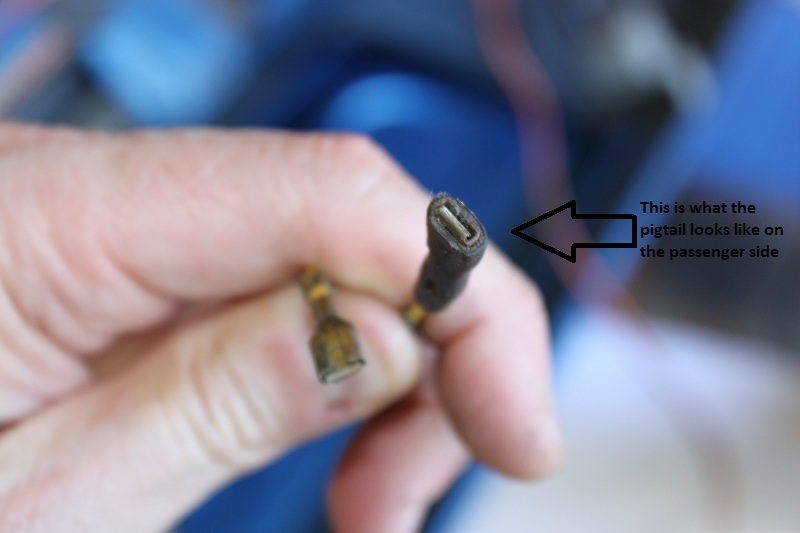

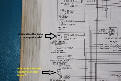

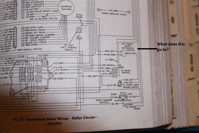

I have attached a few pics of the questions I have. I have wiring that says it goes to the Right and Left Front Door Automatic Switch. What switch is this and where does it go? When I bought the car these wires were just taped up and didn't go to anything. Any help with these would be great. Also, where can I get a Headlamp on Warning Buzzer? Thanks for the help.

these are the switches in the door jambs for the dome lamps...the reason the drivers side has 3 wires instead of 2 is that the drivers side has a time delay for the dome lamp so it stays on for a few seconds when you get in and close the door.

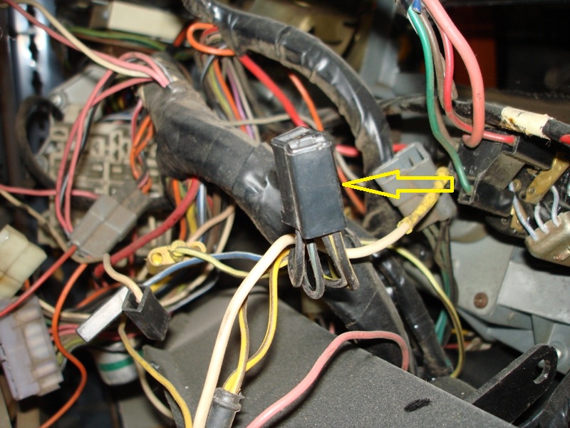

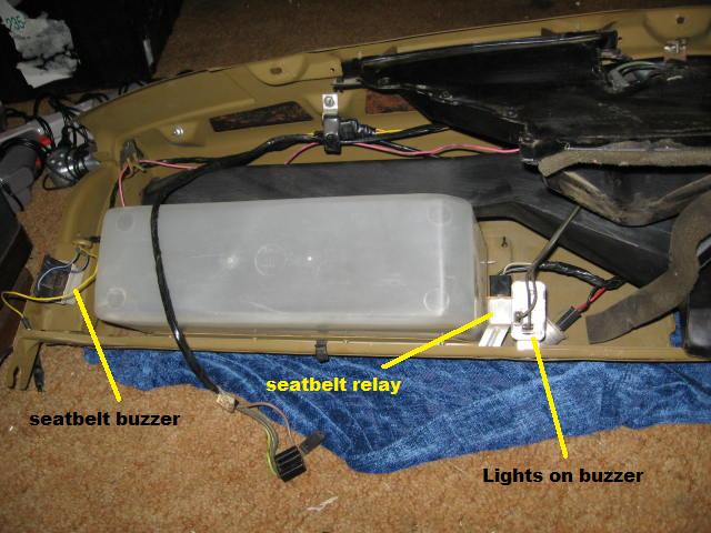

Does anyone have the harness that goes from the Headlight on buzzer back to the wedge connector above the radio that they would be willing to sell? I have attached pics of both ends that I need. Thanks for the help.
