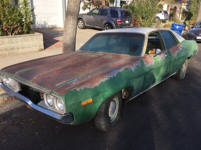

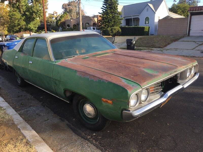

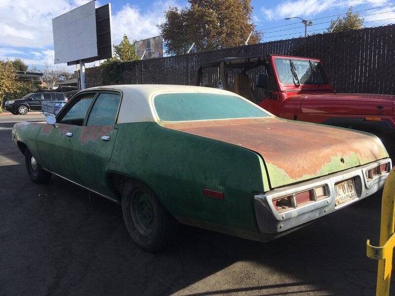

Yeah definitely going with the steelies/dog dish look, former government car so that's the correct look anyway. I guess the question is, with a 235 tire on a 7" wide wheel would i have enough space, or would a 15x6 be better just to be safe?

15X7 or 15X8 as there is plenty of room on that Satellite. The 235/70's is an excellent choice for the front and you can actually go a couple of sizes bigger on the rear for a great stance. IMO
Just saw this, guess that answers my question about wheel width.
Thanks
