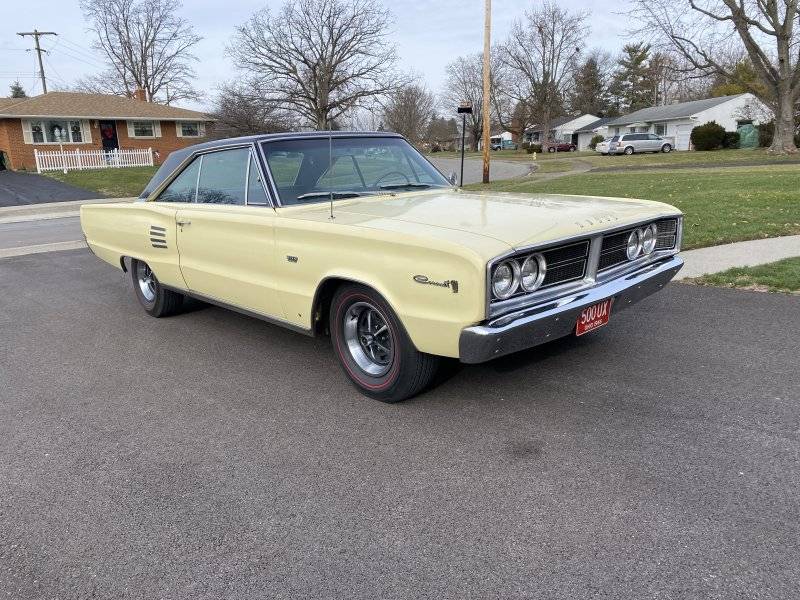

I bought my 66 Coronet (383 4 bbl) 6 years ago and it had the transmission rebuilt before I got it. A Cheetah valve body with standard shift pattern had also been installed. I took it for a ride today and kicked it down after making a turn and it shifted from second to first and then back to second. RPMs were climbing when I accidently pulled the console shifter back into first. It shifted back into first so I quickly shifted up to second and let the engine rev some more. I shifted into Drive but it stayed in second.
I stopped and started some light footed driving again but first gear went to a high RPM (over 2500) before it shifted to second. This is not normal in 6 years of ownership. While driving in second I could not get it to shift into drive even manually moving the shifter back and forth. I stopped and shut off the car and restarted it only to find no change.
I know nothing of automatics. I believe my actions today caused something to cause the transmission to act like this. I am asking for advice on what I should look at underneath next chance I have. I only have regular hand tools and no specialized transmission tools. Any and all advice greatly appreciated. Thanks.

Good News! Got car out and made first check at kickdodn linkage. Went to move it and found it stuck wide open. No real binding so I lightly lubed friction points topside. The return spring probably too light also so I crimped a little more on the straight part of the spring to give a little more pull. Probably will replace it. Took car out and it drove as it should.
Many thanks to all who responded. All responses probably could have caused this situation. It helped me by more knowledgable people giving their opinion. I was a little bummed when this happened because the drive on Sunday was to make sure all was good. I plan on selling it soon for more room and getting my 69 Roadrunner (4 speed) painted. Thanks Again.
