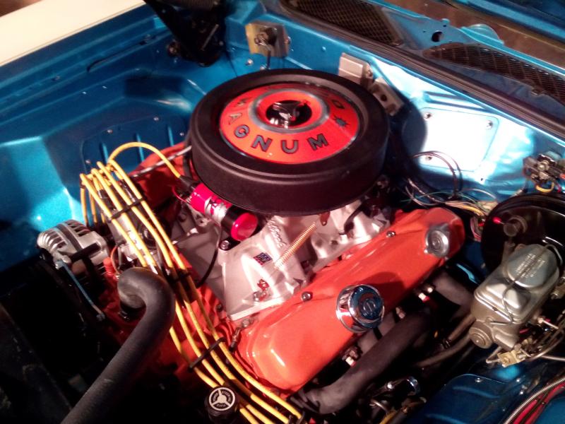

mine came with a small block 727, so the driveshaft is the same as a BB. I am using the 2 core radiator it came with and works just fine. same with the .96 torsion bars. I am using BB motor mounts spaced 1 inch forward. its not as complicated as some would suggest.
You're lucky to live in CO. First swap I did here in FL I barely made it from the shop to the house with the two-core radiator. That 440 was so hot when I got home I couldn't shut it off due to dieseling and I swear I could hear the oil boiling in the pan once I did get it to stop.
LOL , yep 2 core , fan shroud , 7 blade clutch fan , 180 degree thermostat , runs all day around 200 even in traffic on 90 degree days.
