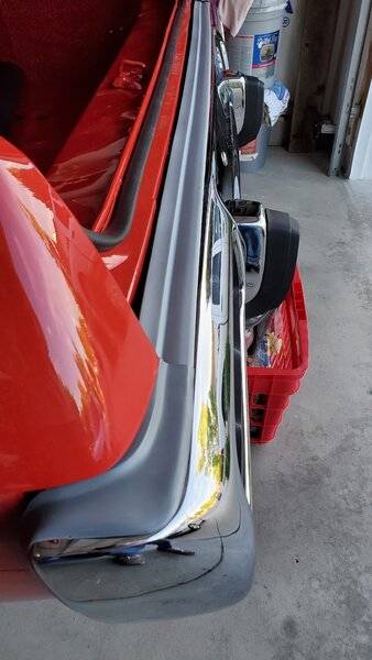

I bought the (over $200 after shipping) ebay corners-
https://www.ebay.com/itm/1973-74-Pl...PER-FILLER-Pair-New-Reproduction/143601187315
My center was in tact and flexible, so I painted it as close as I could get and am happy.
I read that another member ( @idrivemopar ?) had some issues where the corners and center meet.
I'm sure my center has shrunk a bit as it doesn't go all the way to the landings molded in the corners, however there is enough overlap not to show if.....
I could get the center to not sag at the ends.
I don't remember this being an issue before I took it off.
It did come off bowed toward the rear in the center, but I straightened it and it stayed.
Can anyone elaborate on the issue mentioned?
Thanks.

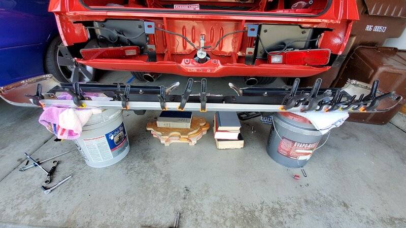

Are your ends original or the new ones. Originals can be restored in most cases by doing 2 things.
You need to re-form them. I made a mold from several pieces of metal strips. Then you need to get a big pan, fill with water and boil the water. With tongs or something similar, dip the pieces in the boiling water for a few seconds. They will then become quite flexible and as quickly as possible put them in the home-made mold. Afterward (or before preferably) clean with Fast Orange or similar that has grit and aloe in it so the material stays pliable but is still being cleaned.
Go here to my website (about halfway down) you'll see what I did and how they came out.
http://www.retrorarities.com/PartsResto/index.html

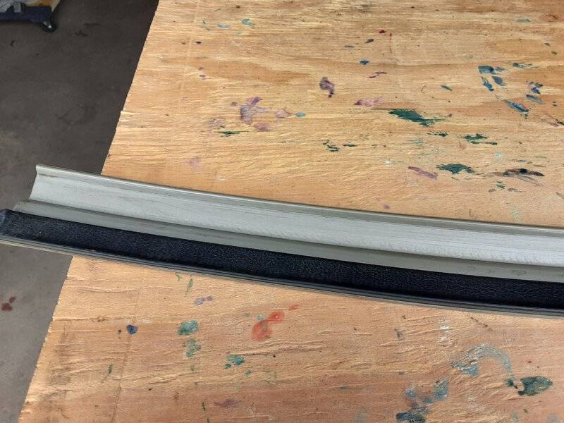

Here is what mine looks like, I put an aluminum strip underneath the center section because the one I purchased was really super flexible and kept sagging under the bumper. I did try an paint, but even using adhesion promotor the paint would crack and not stick very well, so went with natural finish.

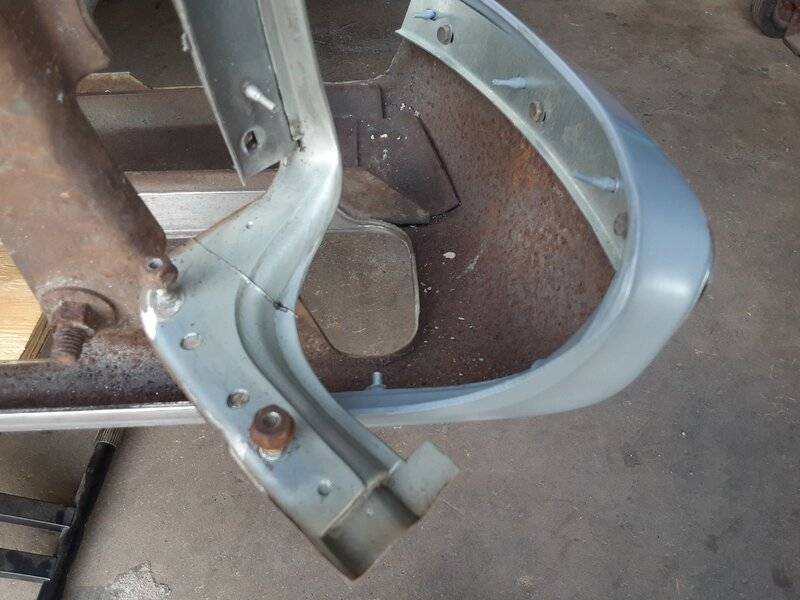

This is the underside of my originals.
Clearly a silvery color.
That's what I remember from seeing them decades ago.
