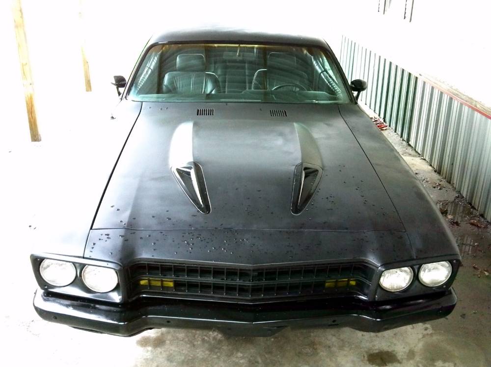

I've noticed that some 73 and 74 RoadRunner hoods have a small surface vent area at both rear corners of the bulge (above the windshield wiper area). My 74 does not have these vents. Can someone explain?
Thx
He's referring to the cowl vents in the hood, up by the windshield...
73 has them, 74 doesn't.
Same on Chargers.
Also 73 has windshield washer nozzels on the hood, 74 has them on the wipers.
What YY1 said. The vents were made in 73 to allow better air flow into the fresh air vents, but they also allowed in debris that would get wet and create rust issues so they went away in 74.

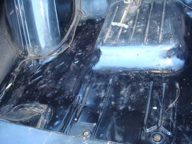

I've also wondered why they changed the trunk floor design between 73/74 and put that hump back there. I think someone told me why they did that years ago, but I can't remember what the reasoning was.

The trunk hump is for the reservoir on the 74 tank top. It makes a 74 tank painful to pay for compared to earlier.

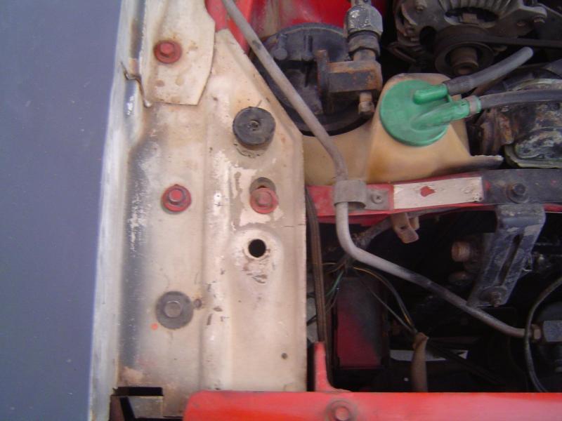

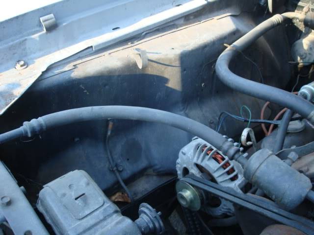

Yes, 73's have canister, here are a couple of shots of mine before i took it all apart. The AC line is on top of it and none of the vent lines are connected.
thanks for the pics. good shot of the overflow bottle placement too! is the horn on a 73 RR same place as a 74?
Thanks idrive. I thought I remembered those being on the 73s and 74s. So if they both have the canister, what's under the hump? I'll be replacing my sender unit before too long and I'll have to take some pics of what's up there.
Regarding the question about horns, on the 73/74, it can have a single or dual horn, they are located in each corner of the fender and you can see the grey bolt head on the fender of the photo above, that is actually the horn bolt on the passenger side. My car for some reason had dual horns, and if your wiring harness has both you can also do duals. Something else you may notice is my overflow bottle is different than most, as my car has a 28" radiator and so the standard bottle does not work inthis case.
