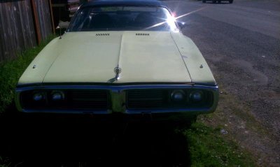

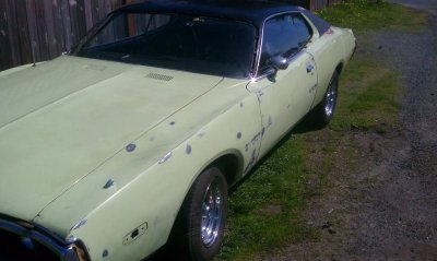

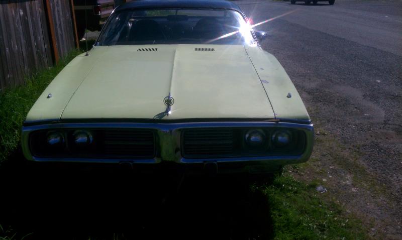

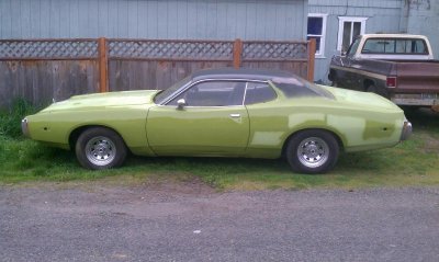

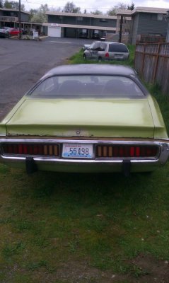

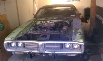

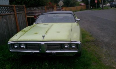

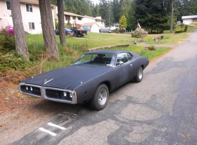

Well since i can remember i have told people that my favorite car was a 69 Charger ....Well when my wife (Girlfriend at the time) said i needed to find a project car so i would quite trying to upgrade my daily driver, so decided it was a great idea. First pick was the charger there where none locally. So i my wife is a chevy girl.. I know its not her fault. Anyway i went looking for a 70-72 Nova found one but someone bought it out from under me. So as am explaining to my wife what happened on my way out of i wal-mart a guy over heard me talking about the bust...and asked me if i would be interested in a 73 charger...not a 69 but close enough for me. This is what i bought for just under 3 grand.
The old man said it was ready for paint and i got a base clear kit with the car but it was not even close to ready in my eyes. So i had to do something that killed a little part of me. Because i lived in washington across the bay from seattle the rain is relentless. I had to take a cheap and drastic action to protect it from further rust. I spray painted it.:violent1:..keep in mind i was in middle of moving from an apartment into a house with a garage but that was a month away.

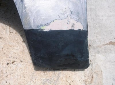

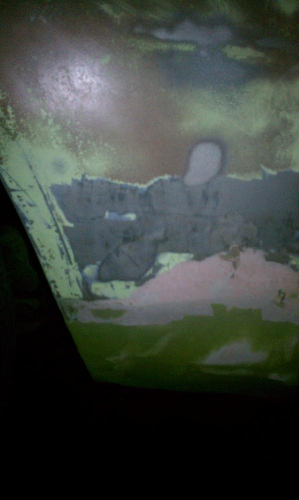

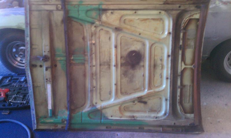

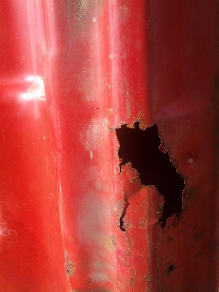

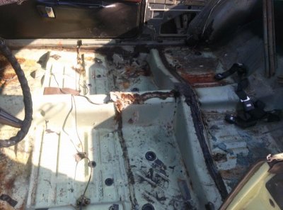

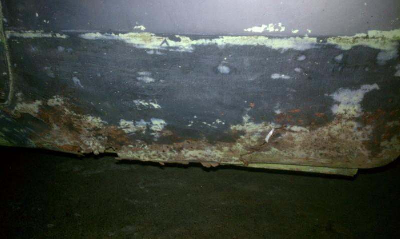

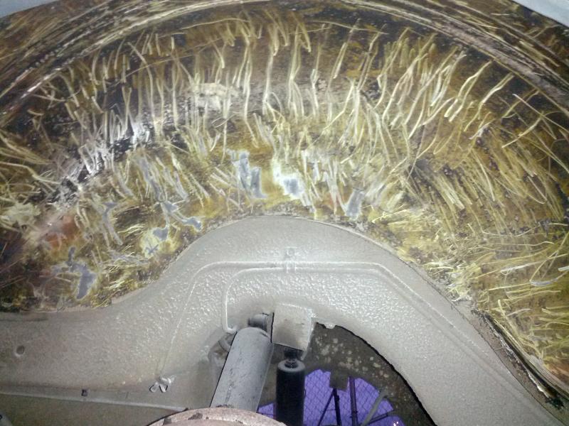

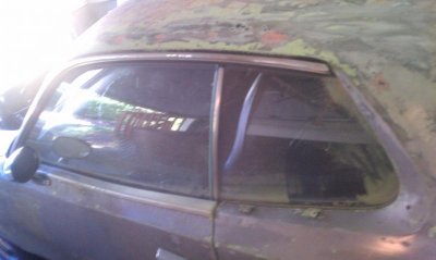

ok so i got her in the garage and started sanding her...there where times i could not wait to take my work cloths off to get started on it....i also found LOTS of unexpected and cheap body work done, like he put a piece of sheet metal against the back of the fender and put bondo on the front...i found traces of chemical stripping and then not cleaning it right.:angry9:

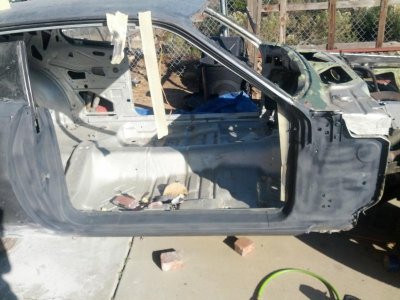

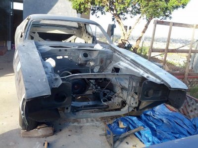

Well i went on an unexpected deployment and she just sat for a while. When i got back i striped her down and found out i was moving to San diego so i primed the car without fixing the cancer and paid for it to be shipped to california.IMAG0110.jpg Couldn't wait to work on it i didnt even get out of work cloths. The guy tried to get the rubber bumpers off and stripped the bolt and my bolt grabber just shredded the bolt more so i cut one off.

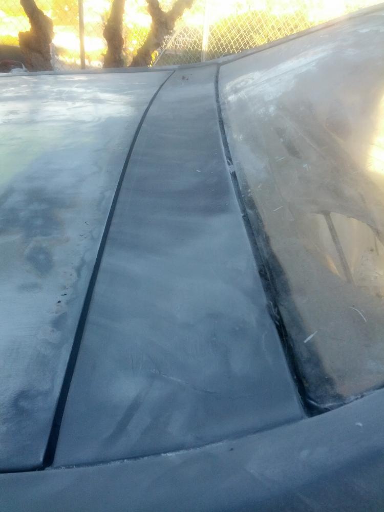

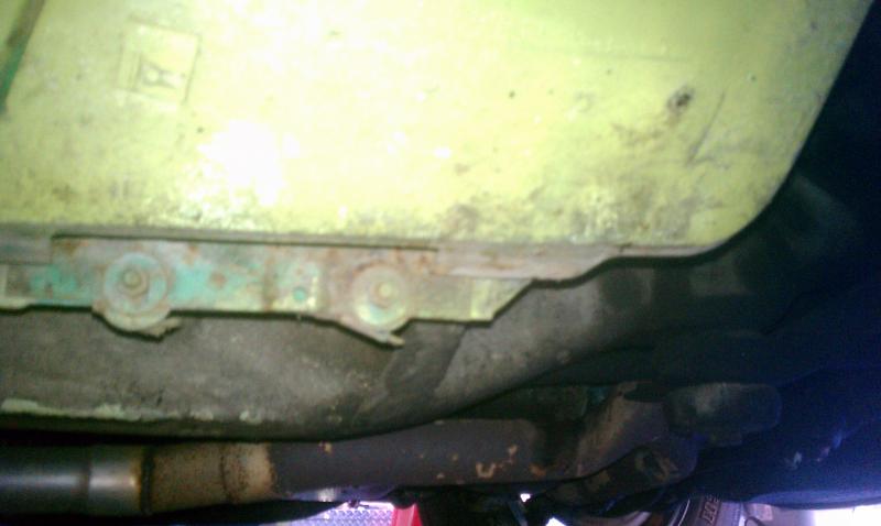

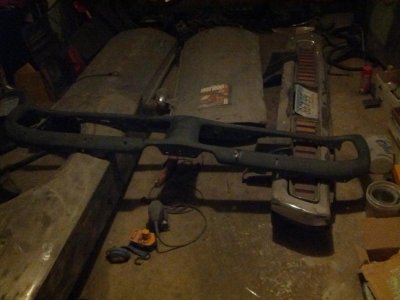

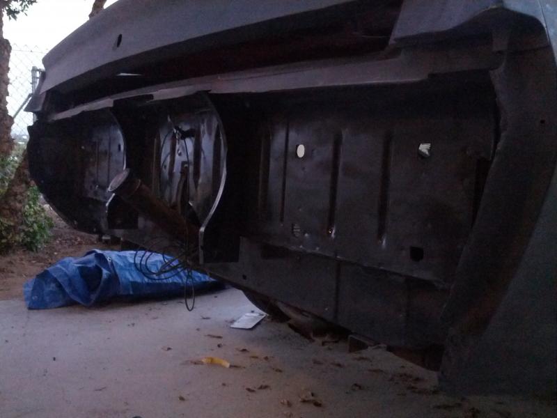

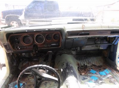

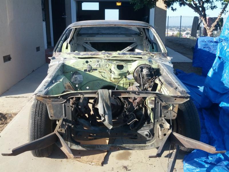

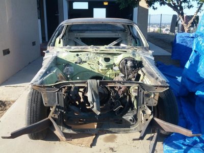

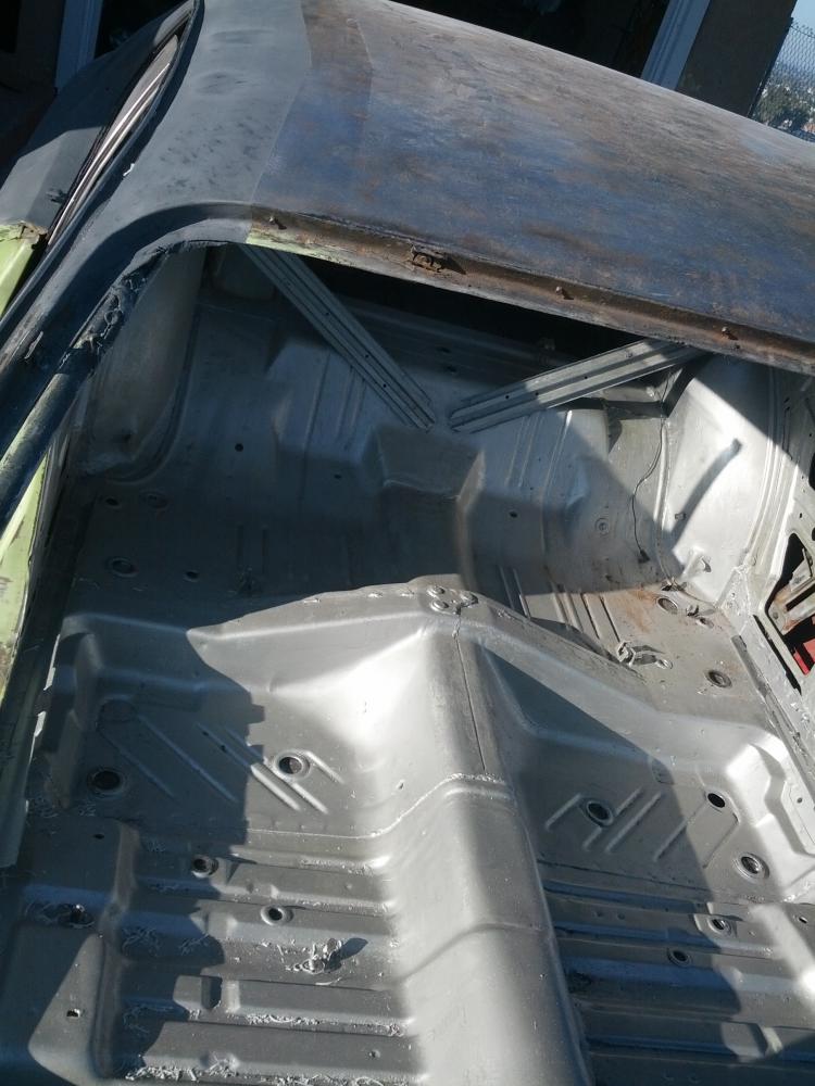

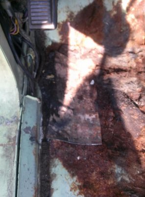

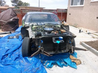

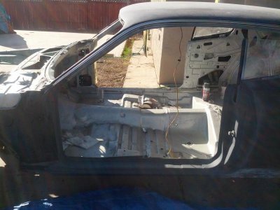

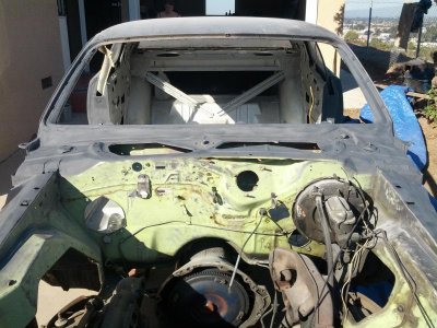

Here is the car to date i pulled the fenders and doors, in the middle of getting the dash out and the steering column..the column dropped but im having problems disconnecting it with the engine still in. Took the ridiculous dash cover that the old man hot glued on and found all the dash pads are cracked. I was hoping to have either patch panels or entire fenders by now but i am having trouble tracking them down...checked with the AMD rep and emailed veriouse web sites non seam to have what i need. Here are some pictures of the car today.CAM00185.jpgCAM00183.jpgCAM00180.jpg

If you got the 4-5 bolts off at the firewall inside, the shift linkage disconnected, at the end of your steering column there is a coupler that has a cap with little tabs. Pry them up so the cap is loose and you should be able to pull your column out and into your car interior. Or also there is a pin the goes thru your coupler that you can knock out, then tap on the end if you can get to it while someone else is pulling on the column. There are some members here that are parting out some 73's, they might have something you need.

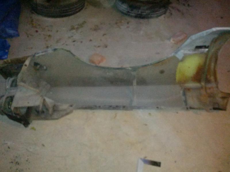

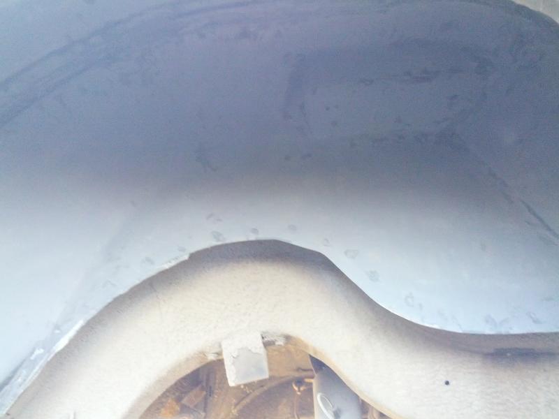

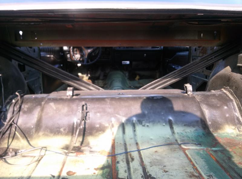

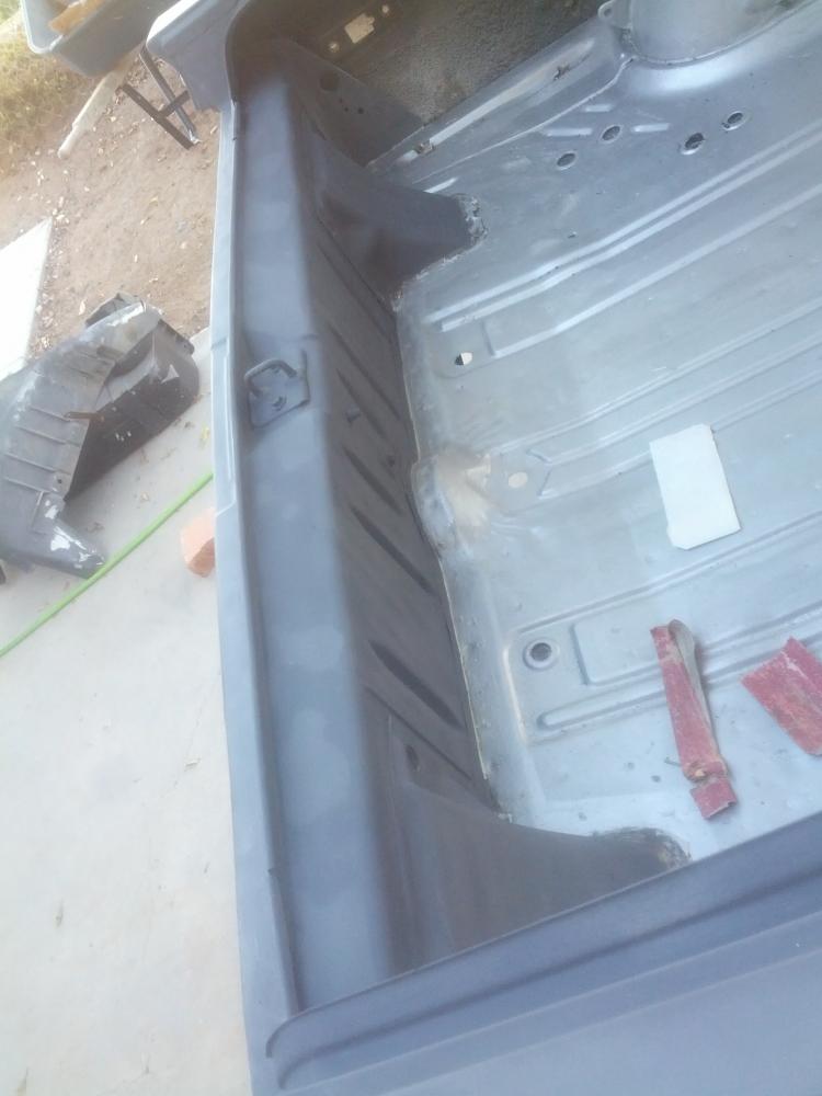

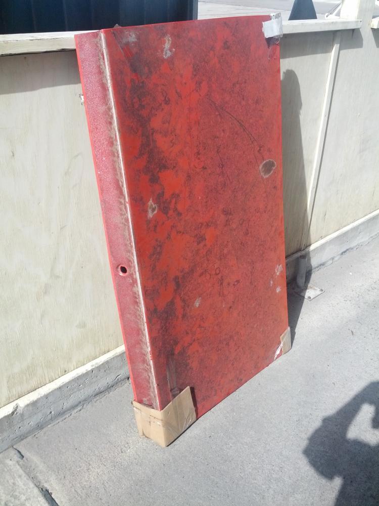

Thanks for the motivation, I have been spending every moment i havent been at work on this car, i got 3 patch panels welded in, 2 trunk cracks filled in, a 2' by 2' section on the drivers floor pan cut and ready to be replaced (by the way that was a pain it had 37 spot weld on that area....Really why?) The engine is pulled and in the shop, The interior of the car is sealed in rust bullet...execpt the forward floor pans. Whew...lets see all i have left to do is the trunk lid (tearing the skin off one to put on the other) and weld in patches unnder the window and then body filler, sand and primer. I picked up the paint yeasterday color code CHR 548 AMBER RED..will post pictures later tonight.

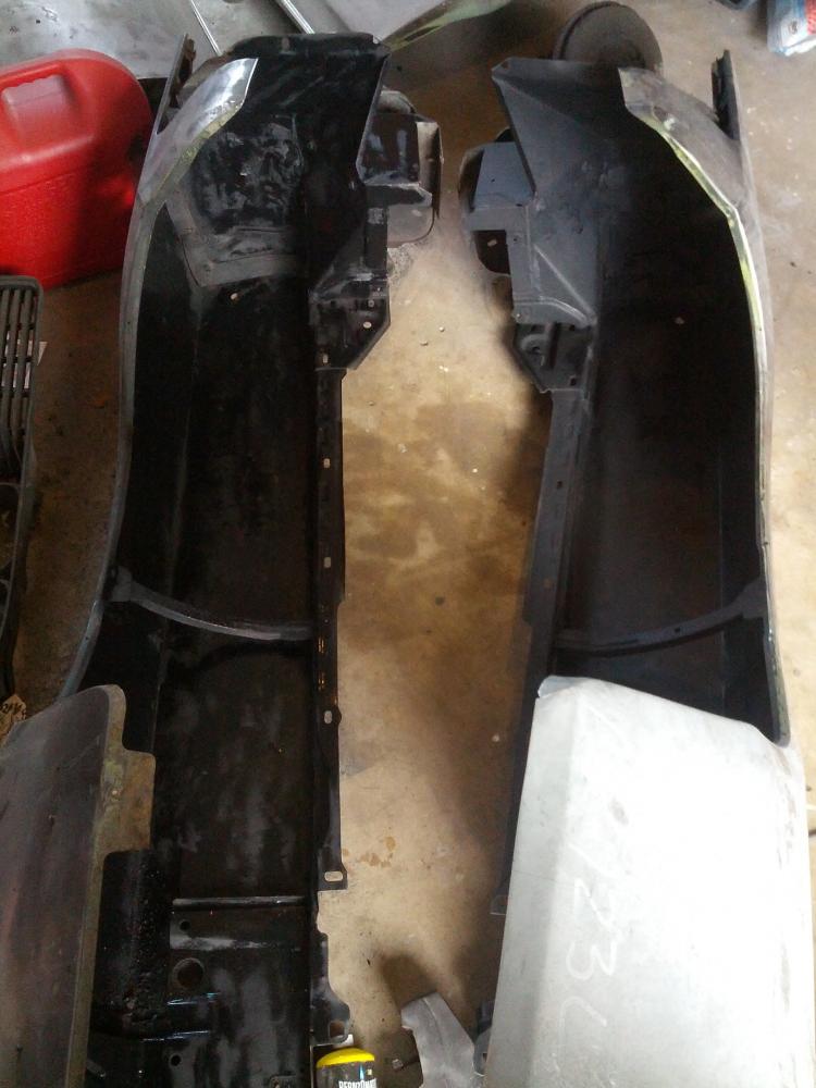

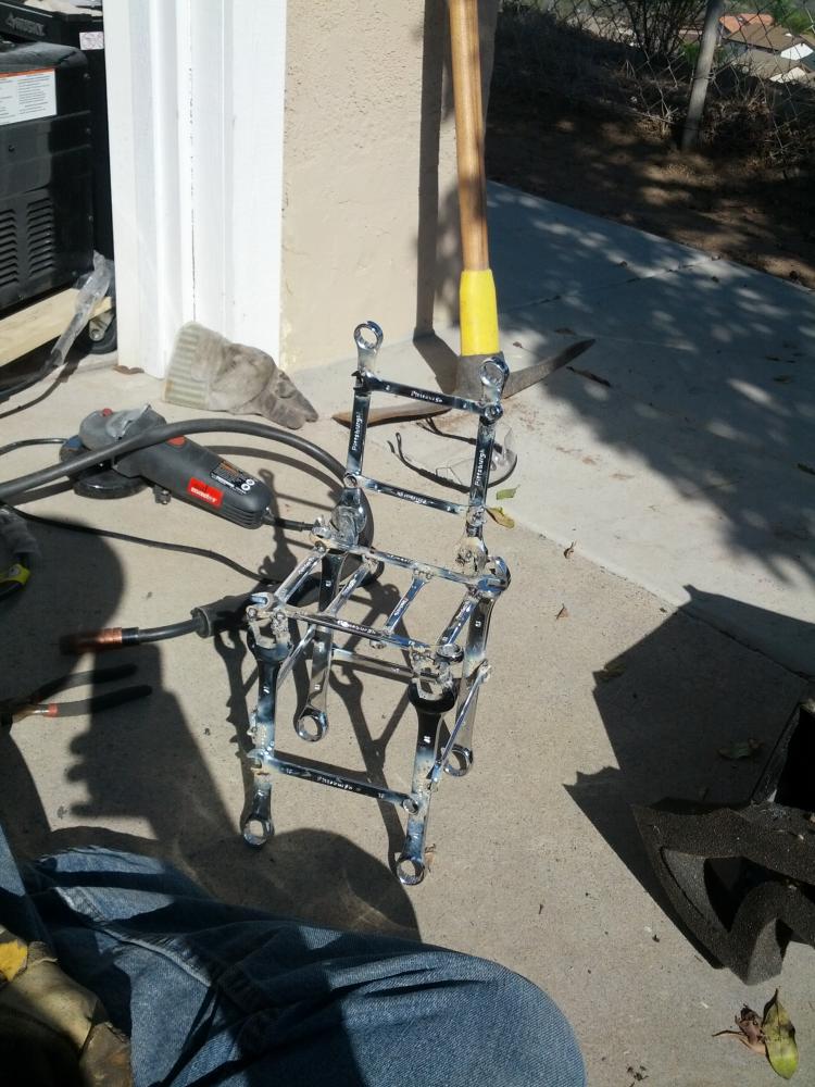

Well here are some updated pictures of my progress and a picture of what I caught my wife welding one weekend.
Nice project your working on, hope you didn't need those wrenches lol.
Its kinda funny i walked out and she is "Trying" to use my welder and then did'nt have the bottle open....the only luck thing out of that mess is she grabbed a bunch of my harbor freight wrenches so i got bought craftsmen to replace them....needless to say she is kicked out of my garage.
