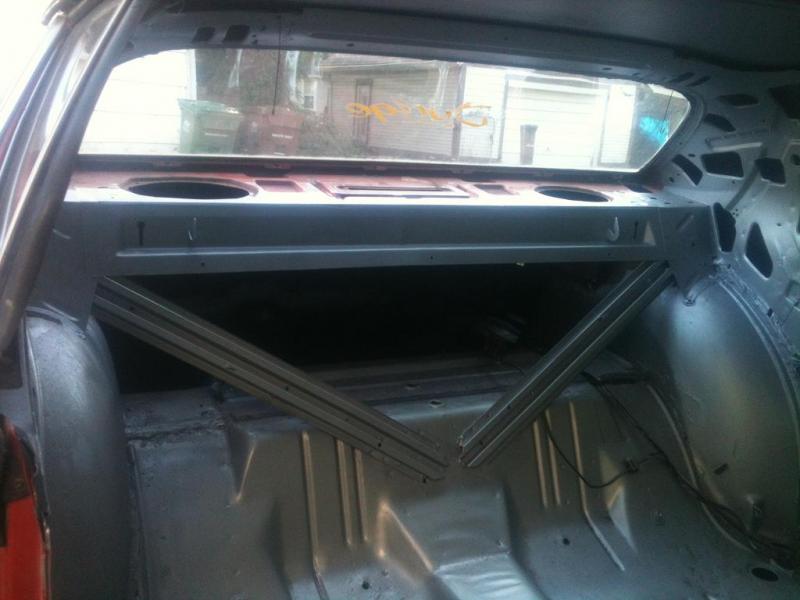

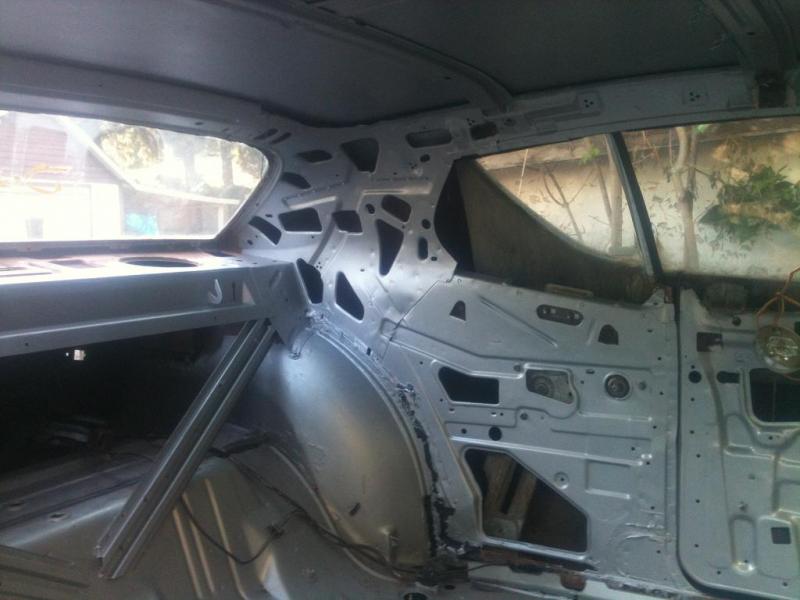

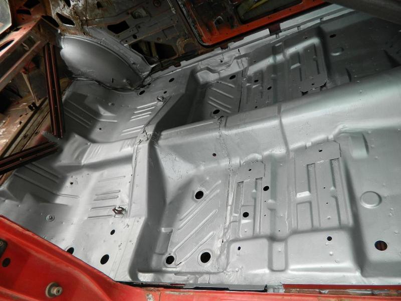

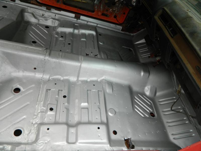

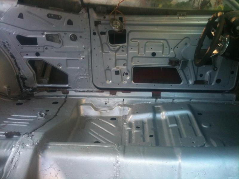

I would put something on there that stops the rust from spreading or take as much rust off as you can than spray with some epoxy/self-etch primer. You don't want to just put the insulation up there as that will trap the moisture/rust in between and it will keep spreading. Do what you can now as long as it is open.Sorry i live in st albert just north of Edmonton
Well i have fin trunk and have done my 1 coat and is starting to look better and second coat is done in the car now. So i have a question superfreak, my ceiling looks like it has had moisture looking rust but not rust rust on metal should i use a coat of rust bullet on it or just some insulation material. Thx
I'm not far from you either. I live in Lloydminster. Let me know if I can be of any help.
Clean the rust off with a scotch brite pad on you angled air grinder and then coat it with the rust bullet and call it done. Get in all the nooks and crannies. I did some work in St. Albert 3 yrs ago and a very good friend of mine lives there.
