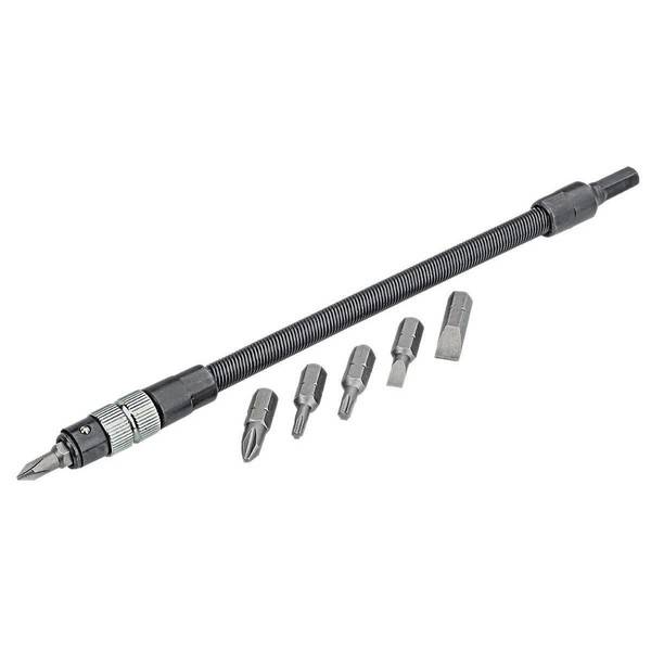

I got a fiber 1/4" extension for HF that is about 6" long and moderately flexible yet not wobbly.
Almost the exact right tool for that job.

I would have gladly paid $100 for this $5 tool-

Especially if you have that $5 tool I posted.

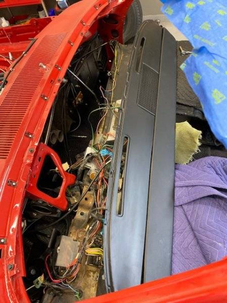

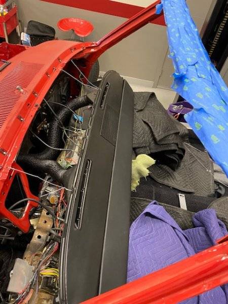

Two Five Gallon Paint Buckets, plus two Moving Blankets work GREAT when you rotate the dash back. Then you can fiddle with the widgets behind the instrument cluster as the dash comes out. Best, B.
Or, as you can see, I used two Coat Hangers to hold it as well. I have a 4sp car and I have to use two really thick blankets on the 5 gallon paint cans or the dash rests on the Shifter. Best, B.
That's not a 73, but since you posted a 66...
Which bolts are the ones you have to remove the windshield to get at (which you don't have to do on a 73)?
On the 66, there are 5 bolts that are right behind where the Windshield lays. You can see the Bolts as they are Black against the Red of the car. I was just showing how you might lay your dash down when you get your bolts out rather than holding onto it while undoing all the connections behind the dash.
Oh, and the wires are going through two of the bolt holes that hold the Dash in place on the 66. Best, B.
