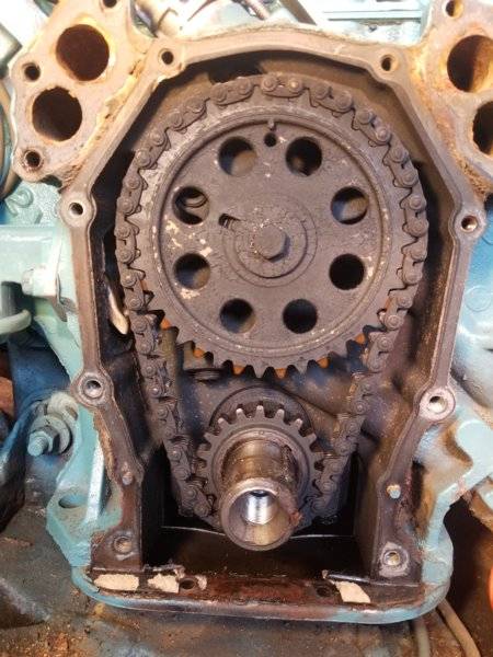

Hello Guys, Again I want to thank you all for your inputs....What is wrong with this picture I have attached? It totally blows me away someone could do this. It looks like @400sforever and @Blackbee603 were on the right track. Yes the cylinders were washed out and the cam timing is 180 out. I am also concerned about the oil pump. Since the car sat for many years, I wonder what damage has been done with oil going to all the parts. I pulled the valve cover and see the lifters are collapsed. Since the oil pump is external, I was thinking about pulling it off and checking its tolerances. Does anyone know if I can blow air into the oil pump ports here to see is the pickup screen is clogged? I am just about at the point of pulling the engine and seeing how much I am going to need to rebuild it. I will be checking the wear for the bearings and looking at how much cylinder ridge I have. That could give me an idea of how much machining I need to get done. At least I will know what I have. Your Thoughts?
What is wrong in the picture?? The crank comes around twice for every revolution of the cam. The cam timing looks OK to me, and the crappy plastic gears not missing any teeth?? I think you may be right, if the oil pressure wasn't pumping up the lifters are down, but the valves should open some and I still think you should have fed gas through a working carburetor to start it and it would likely have fired up. Just guessing from this viewpoint tho.
Do what exactly??

Timing chain was not off 180 out, basic timing (distributor) was.
