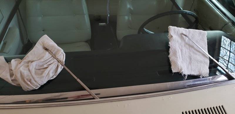

Ok, so what I thought was going to be a simple thing has (potentially) snowballed... My wipers stopped working because two of the nylon bushings on the wiper linkage disintegrated, as 50 year old nylon bushings tend to do. No big deal, I got some replacement bushings an was going to install them. As I was starting to line things up so the wipers would be in the correct park position, I noticed that they didn't seem to have been set in the right park position. They parked on the bottom of the windshield above the hood. It looks to me like they should park below the hood, resting on two bump outs on the chrome trim piece under the windshield. Question 1: Is that a correct assumption? If so, we can move on to Question 2...
I then noticed that the current wiper blades (replacements from a previous owner) were too tall to fit under the hood with the adapters on them that allowed them to attach to the bayonet style wiper arms. So I started looking at things closer and I found that the replacement blades were 18". I believe they should be 16" from what I've researched so far. No problem, I got some 16" blades with a seemingly lower profile so they would (hopefully) fit under the hood in the correct park position. They did not. So, Question 2: Is 16" the correct wiper blade size?

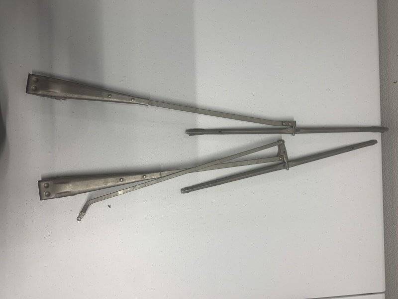

Since this didn't solve my problem, I took a closer look at the wiper arms themselves and noticed that the driver side wiper arm scrapes along the chrome trim under the windshield as it moves. I know that's obviously not supposed to happen but I couldn't see a way to get it to clear the trim and move without scraping. That's when I started looking up pictures of wiper arms for 73 Chargers/B-bodies. I noticed that a lot of the wiper arms that came up looked different than what's on my car. Mine are just straight arms with the flat bayonet style attachment at the end. What I'm finding online is that the wiper arms that appear to belong on there are different than what I've got. One of them has some kind of stabilizing arm on it. Also, the connections are a side facing pin style instead of the bayonet style - which seems as though that would allow them to clear the hood to get to the correct park position. I've attached two pics of wiper arms here. The first is what's on my car and the second is what I am finding on the interweb as potentially what should be on there. Which leads me to Question 3: Does my car have the incorrect wiper arms on it? I really don't want to (nor can I afford to) spend $100+ to replace the wiper arms. I've got other bigger issues to deal with first. So I guess the big question, Question 4: Can I just leave things as-is, change to 16" blades, and just set the wiper linkage so that the park position is at the bottom of the windshield when I replace the bushings? and Question 4a: Aside from the aesthetics of the wipers not technically being in the correct park position, does it really matter given that I barely ever use the wipers since I rarely if ever drive this in the rain and I really only need them to pass inspection? I guess what I'm really asking is, will doing this cause any problems/damage to the wiper motor, linkage, etc or would it be fine to leave it as-is and just replace the bushings and blades until I hit the lottery?

528-6 3.jpg#1 Arms should be parked under hood on the stops
#3 They appear to be incorrect Mine look like what you have in the second pic.
#4 You could get by with what you have if you have greater priority elsewhere. I would not scratch up that trim panel if I could help it.
I do not know if all '71-'74 B bodies had the same wiper arms. If so you should be able to find them at swap meets.
Agree with the above.
#2 16” is correct.
#4 71-73 arms are the same and 74 had the washer line connected to them. Your second pic is the correct arms. You can try the arms you have but the drivers might not pivot or park correctly.

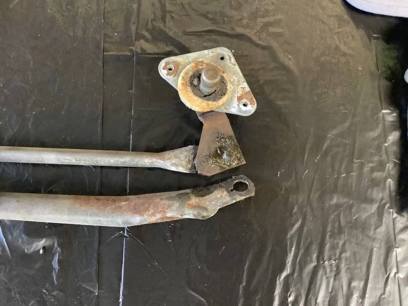

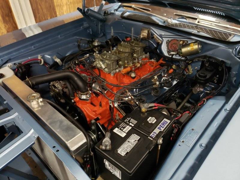

I had wiper issues for a number of years until I finally decided to dig in. The parking problem on my car was a plastic bushing on the driver’s side pivot that moves both wipers. The arm from the motor was literally just sitting on the post. Wipers parked above the hood but you could push them down on the stops. I will post some pictures that may help.
I found the correct wiper blades with the lower profile to fit under the hood properly. Now wipers work properly and are quiet.

Thanks! I found a set. Just got delivered today and they look ok. I got the set for just under $50 including shipping. I feel like that's not a bad deal. Hopefully they're good. They have the side pin attachments for the blades instead of the bayonet end. Looks like everything is there.

Welp.......... I got a wiper arm removal tool and took the arms off. That went nice and smooth. However, once I got the arms off, I saw that the @#$%!& who put the wrong arms on also broke the pin off the driver side pivot so that they could fit said wrong arms on so now there is no way to attach the tracking rod. So now I have to buy a replacement pivot for the driver side - one that still has the pin on it. Aaaarrrggghhh!!! Every time I think I'm making progress with this I get a big ol' punch in the gut to set me back.
Anybody got a driver side wiper arm pivot for a 73 B-body they're looking to sell?
On the up side, since I had to take the arms off anyway, I removed both pivots and all the linkage from inside the cowl so that I can clean it all up and grease all the connection points. Not to mention have a MUCH easier time replacing all the bushings. So I've got that going for me......which is nice.

Just an update for anybody who's still interested... I got the new pivot and it's in great shape and has the pin for the tracking rod. I got all the linkage cleaned up and put back together with all new bushings. Everything went together pretty easy using some white lithium grease and my vice. Only had one bushing blow out but I had a couple of extras so no problem. I got the linkage/pivots reinstalled in the car - that was fun...not. Ran the motor (without the arms attached) to test the linkage and everything seems to work just fine.
