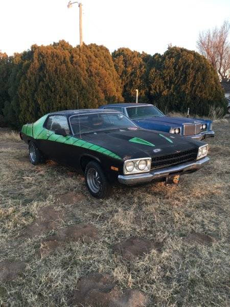

So I picked up a 73 roadrunner factory 400 car. Swapping in a nice 440. It had headers on it but they are rotten and make the starter a pain. I have a 440 out of a 71 imperial setting out in the barn. Would the manifolds off of it fit in my 73 b body? Or are there headers that don’t make the starter a pain to change? Thanks to all

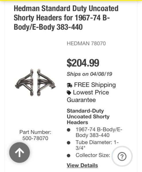

Has anyone tried the Hedman shorty headers for b bodies. 73 runner 440 manual steering I know they use a mini starter
Any late model magnum starter works. I bought mine off of a 98 ram 1500, It makes the starter installation with headers so much easier to deal with.
