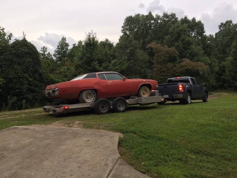

I have a 73 Roadrunner that I’m installing a healthy 340 in. Originally 318 with an 8 1/4 car, now I have an open 8 3/4 for it. I’m rebuilding the 8 3/4 with a sure grip, my question is the ratio. I’ve had 3:55 in a 340 swinger and 3:55 in another 73 Roadrunner with a 400 and enjoyed both. I’d like to try 3:91 for a change. I live in the mountains and I really wouldn’t be doing much if any highway miles. Does anyone have any real world experience with the 3:91 gear set in this combo? Thanks
