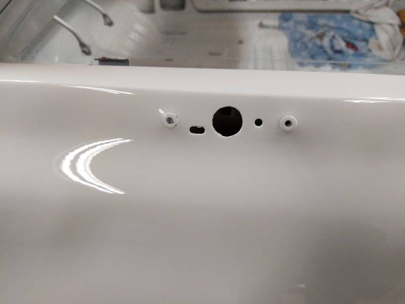

That looks like E body (also 71 B and maybe 72) that uses a "nut-sert".
If the holes in your door look something like this.

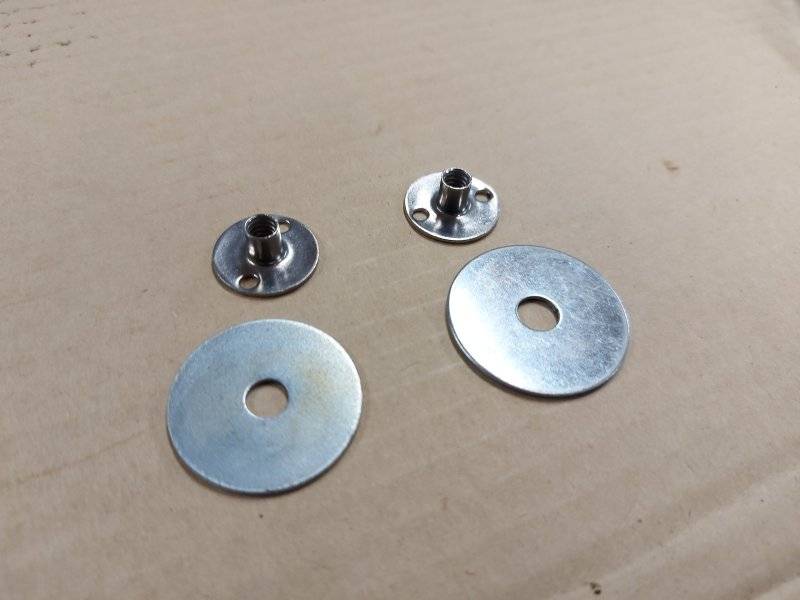

Then just go to your local hardware store store and get these.

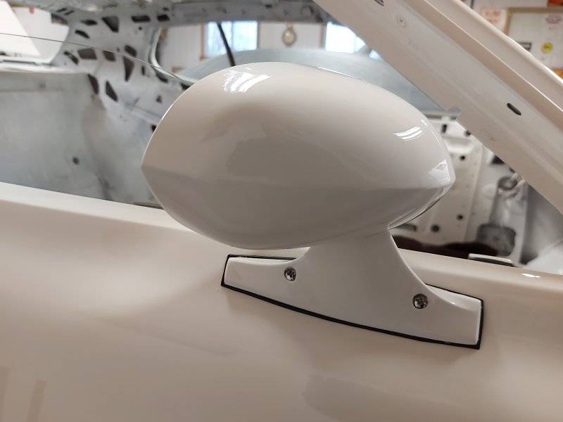

A couple of furniture nuts and stainless fender washers.
That's all I used to mount my mirrors.

The pic in post #10 about is for 70 E body. Some early 71B used the same expansion nut anchors. Later they have a metal plate that is held in place with a couple plastic rivets. My 71 RR built 10-70 had the plate.
Pic 13 already has the nut-serts installed.
I've had bad luck with those spinning in the sheet metal they're expanded into.
My guess is that's why the factory changed the design.
