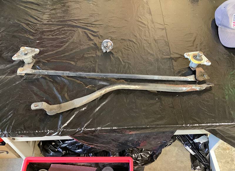

HI all, I have had this thing in the shop several times and it is getting frustrating.
1) wiper bushing broke (I couldn't get the motor off to replace them and took it to a shop.. they fixed them but the arm's weren't going back under the cowl.

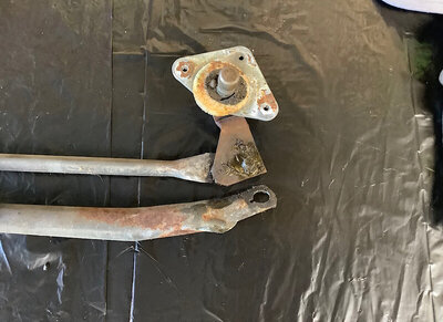

2) took it back to fix, they said they fixed.. tried them in the rain and they go up 1/2 way down they lock up the blade turns sideways (dr.side) then the extra arm on the Dr. side the pin snaps.
3) took it back again they fix and again are having a problem getting them to shut off in the proper place. their still stopping on the window. they called and said its fixed and returning under the cowl..
4) I get it home its raining this morning i turn them on they only go 1/2 way up the window and return under the cowl during operation??????????????????????
I take it back they see it is only going 1/2 way and tries to tell me well it must be in the motor? it was working fine when I first brought it in??????????????????????????????
it has now been almost 2 months working on this.................................
Is their two spots on the motor wheel for two different setting???? like for old school short stroke and the newer one's longer stroke.
Thanks take care , be safe
tim
OH.. Could they have accidentally swapped the arms in the cowl?? cause now it has a real short stroke.??

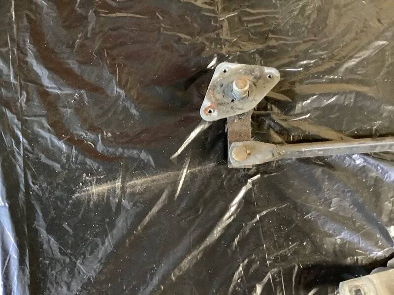

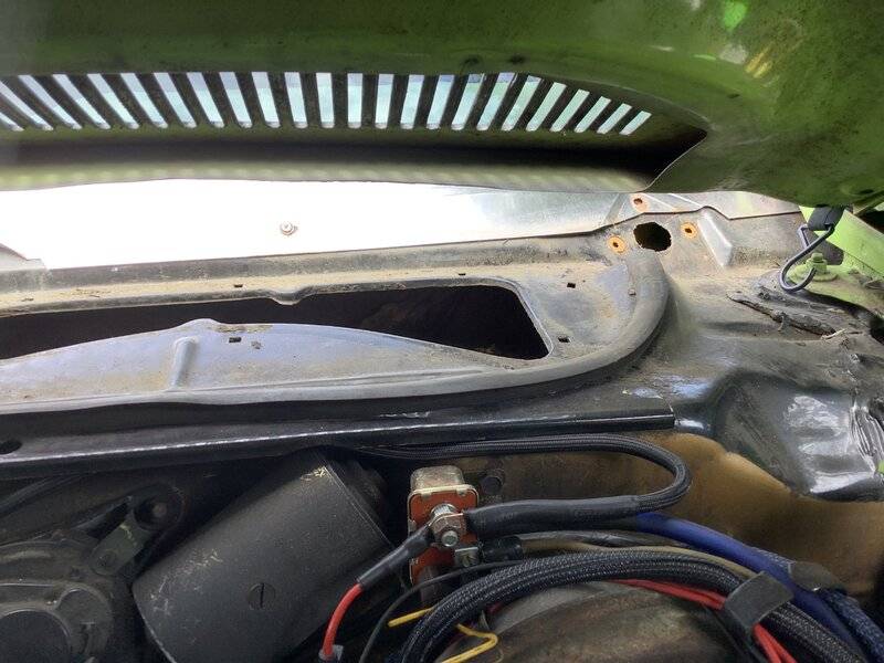

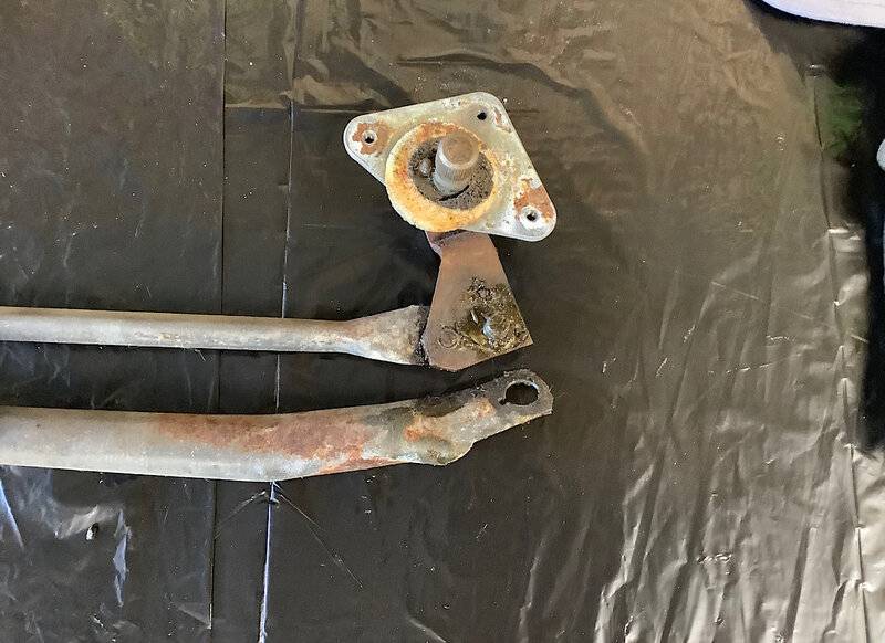

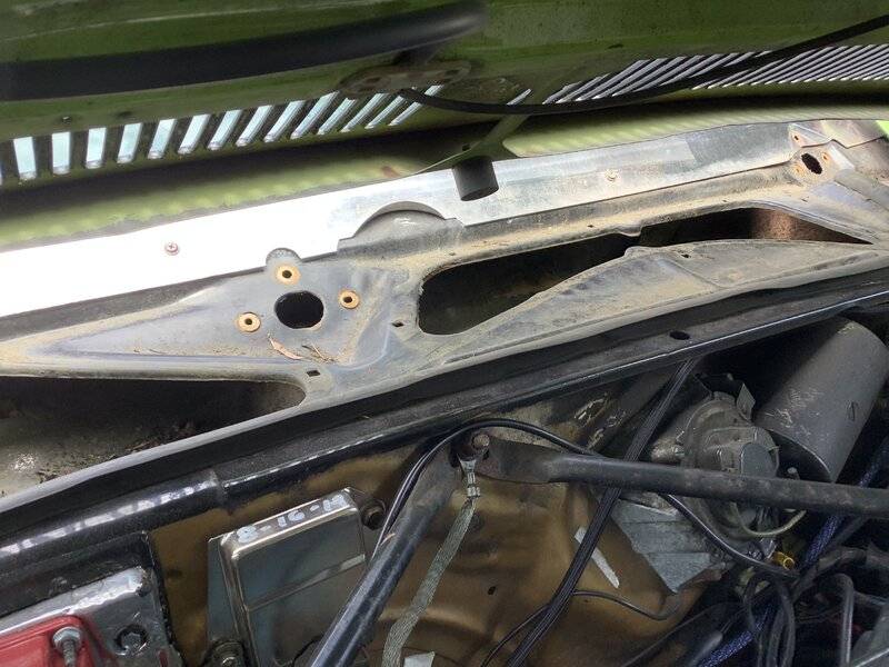

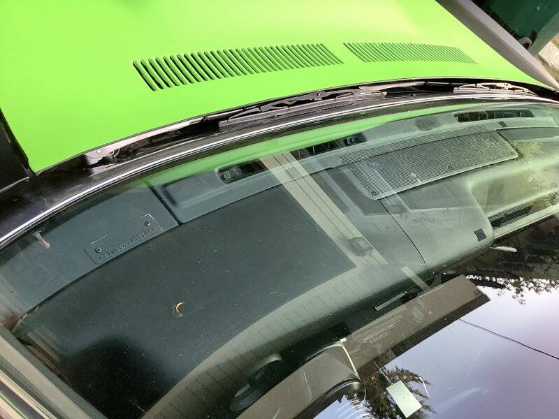

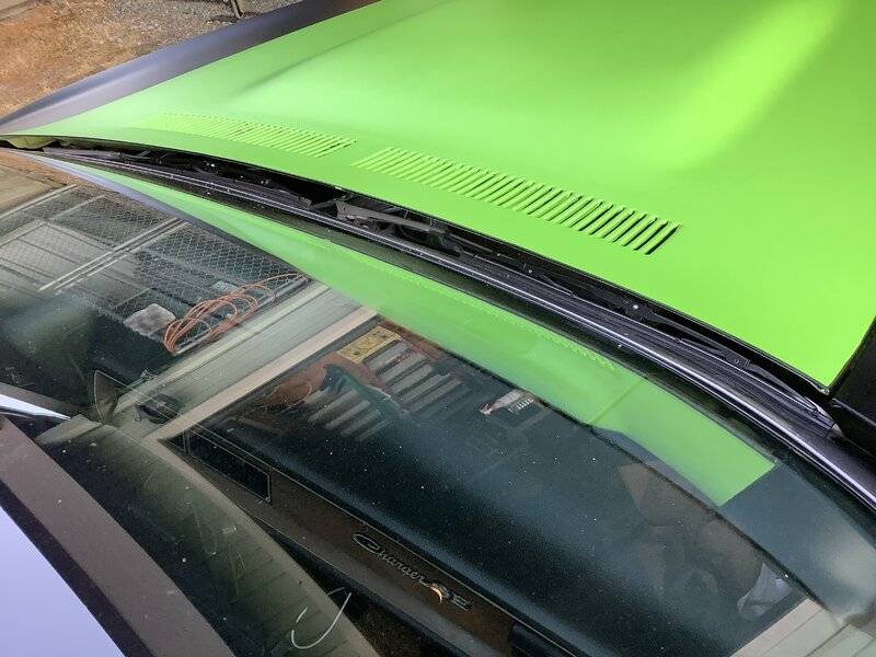

236158D5-A398-4EAD-A17F-38B3B9E27FA2.jpeg 44020EA7-6C0A-40E1-B0A8-CDDE49964E23.jpeg 51663940-DF66-4CA0-841A-73C57EFFDB92.jpeg 76635FA2-94E2-49FD-8065-FB7F7F48ADF8.jpeg 5154F30E-F1D8-4270-9E9E-01FEC6B307ED.jpeg A2FA6D55-AE16-423E-9857-A126321A0F1E.jpeg 5C4F9762-E629-4B2E-A39A-DAD4239E0C4A.jpeg 75E5A651-C82D-4BF5-8C57-DB9FA909AE22.jpeg

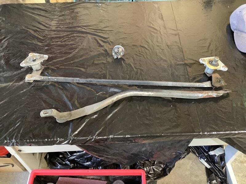

Yea.. I can't get a picture of the inside of the cowl.. but if your parts are laid out like they hang .. it looks and feels like they have the control arms swinging up over the top instead of swinging at the bottom..
SO Are they suppose to swing at the bottom??
Thanks
tim
HI all.. THANK YOU ALL got it back into the shop after I investigated the problem here and internet, and found out the problem , they had assemblies it wrong. They had the control arms going up over the top of the arm pivot when they need to swing at the bottom.. I told them what they had done and what it need to fix the problem.. simple fix.... got it back last night and the wipers run perfectly.
The shop forearm keept trying to tell me that the motor must have forget where the stop is?????????????????????????? But I knew that wasn't right.. as it was running perfectly when I took it in .. other than the bushing broke on the control arms.
