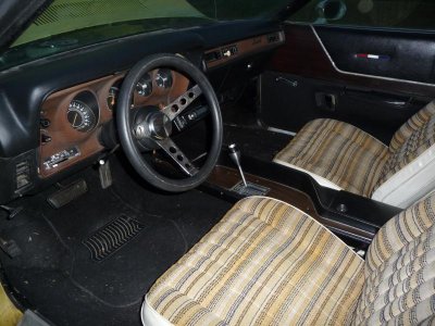

I can't verify this beyond a shadow of a doubt, but I believe the bucket & bench seats should interchange. That's probably about it from the interior, maybe carpet? Why do I believe this?... I've had my 72 sebring plus for about 15 years now, and when I bought the car it had a seat cover option that I had never seen before. It wasn't until I saw an older issue of Mopar Muscle featuring a 1975 roadrunner that I realized it's bucket seats matched mine. I think it was a package closely resembling the "Sundance" package from the 74 satellites. One of the previous owners of this car was a multi-mopar project guy, and I suspect he took out the original white bucket seats from mine for another project car and replaced them with the ones you see below. I replaced the white door panels with black ones years ago but I've already got some white 71-72 vinyl seat covers to recover these with... then I'll dye the door panels white. Below is a pic of the 75 sales brochure as well as a pic of my current interior (rather dirty I might add). Either way, the seats fit in mine. Hope this helps! Maybe someone else can chime in if I'm wrong.
