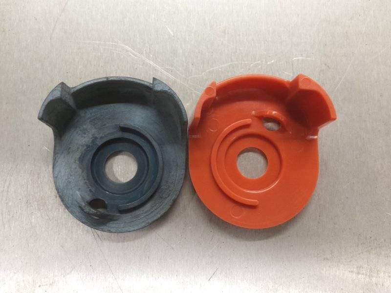

I bought this from 59imperial on ebay.
Some of the parts match. So I think it will work using one of my old parts? As you can see in the picture, the crank side part detent ball recess is 180° out of phase of my old dark blue part. So I guess that's what I will try.

Just curious? So I bought my bushing kit from 59imperial on ebay. And the lower bushing is reversed from the one on my 78 magnum. luckily my lower bushing was still good. So, which lower bushing will these new kits have? And why is 59imperial not selling the kits anymore? Will these kits be affordable? My kit from
59imperial was $90 shipping included.

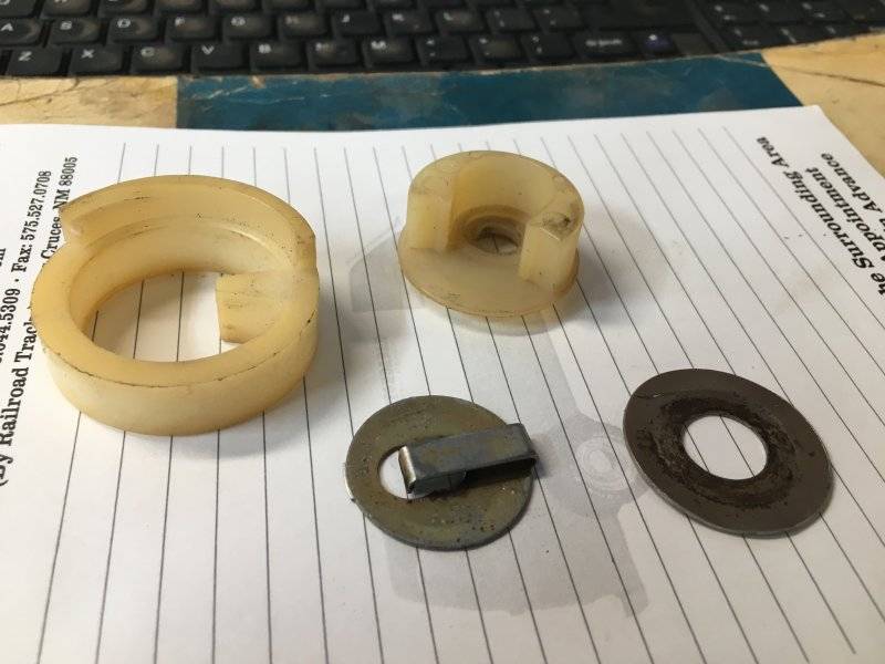

How about this one? I think it is for a 3 spd, wont fit my 2spd.
This is part# 3879325. It fits a bunch of B, C and E bodies from 69-77. It happens to fit my 77 Cordoba. It doesn't happen to come with any instructions as to where the "V" fits in the spring?
You could use this but the arms won't park. I used one once and it works fine, just have to push the wipers down to park. No biggie
