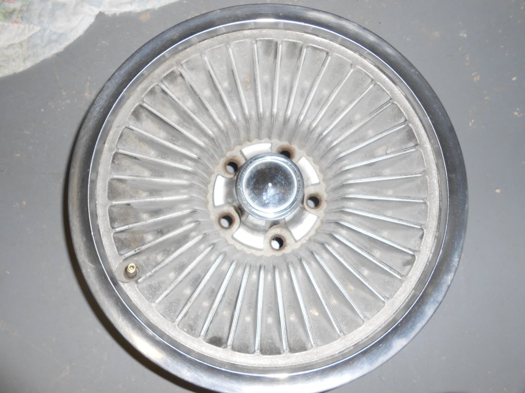

There was optional turbine effect wheels on earlier model doba's that I'm partial to. I have a set of four in interested.

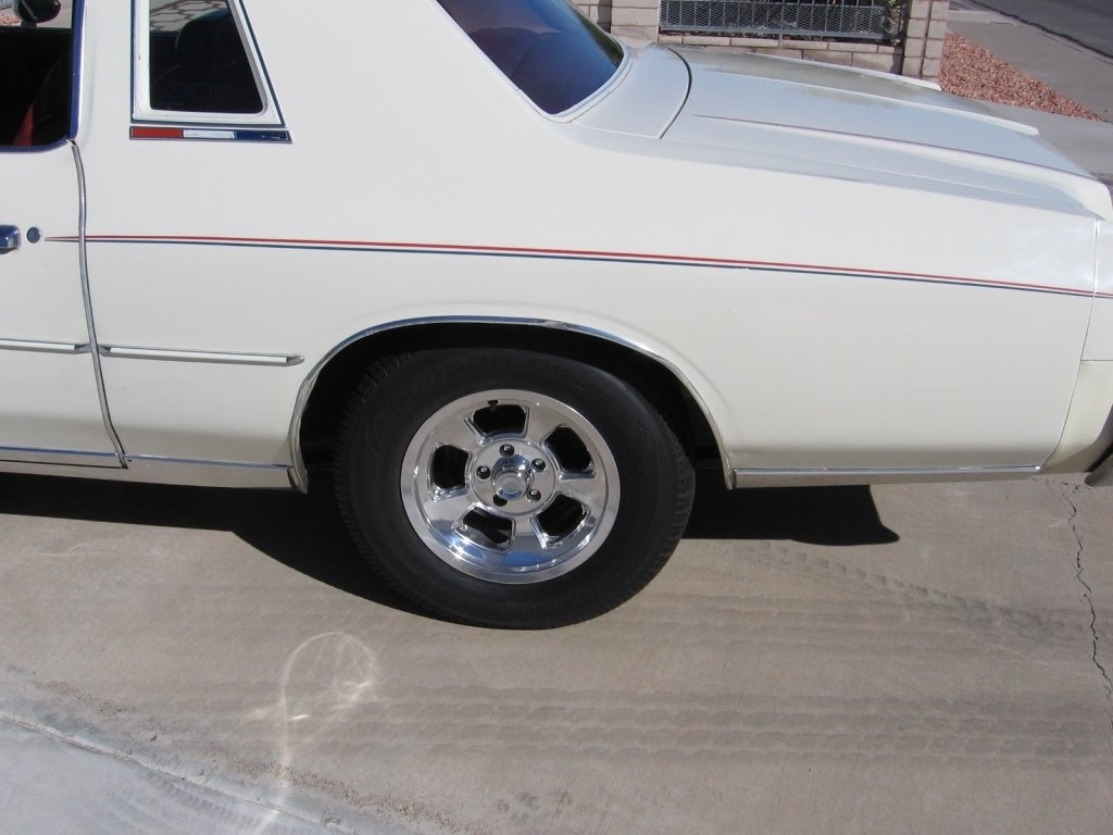

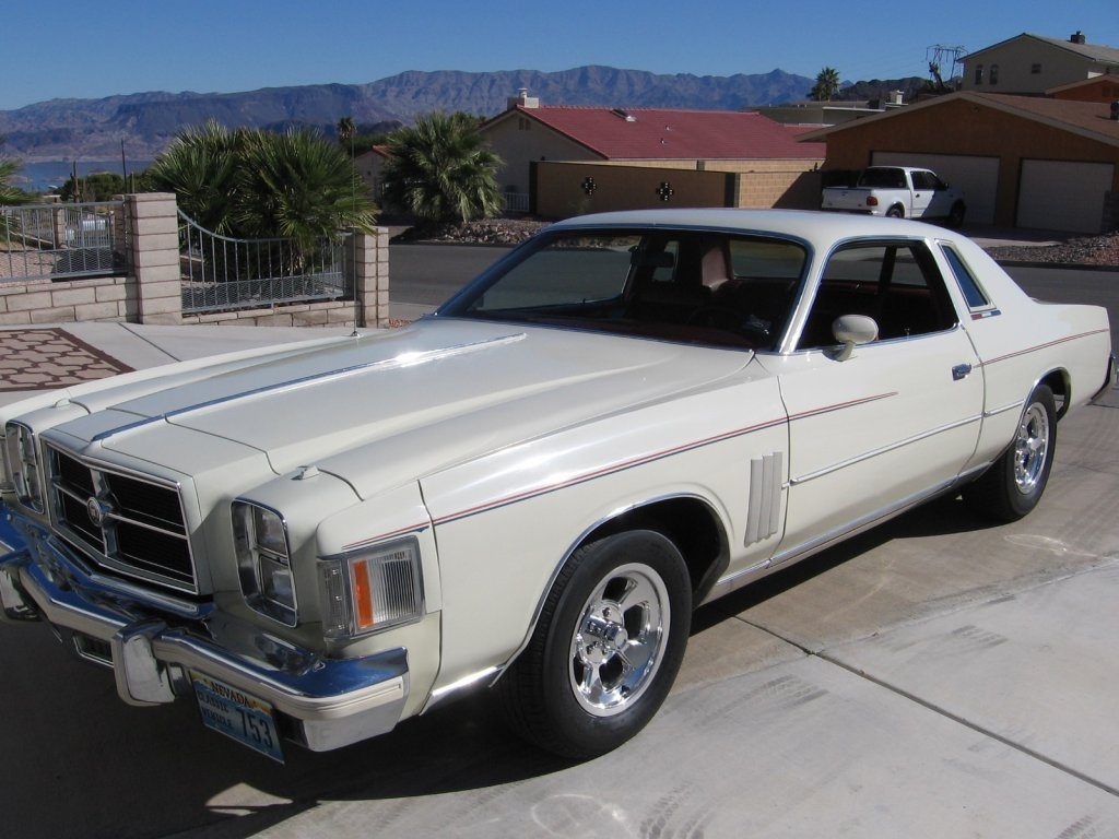

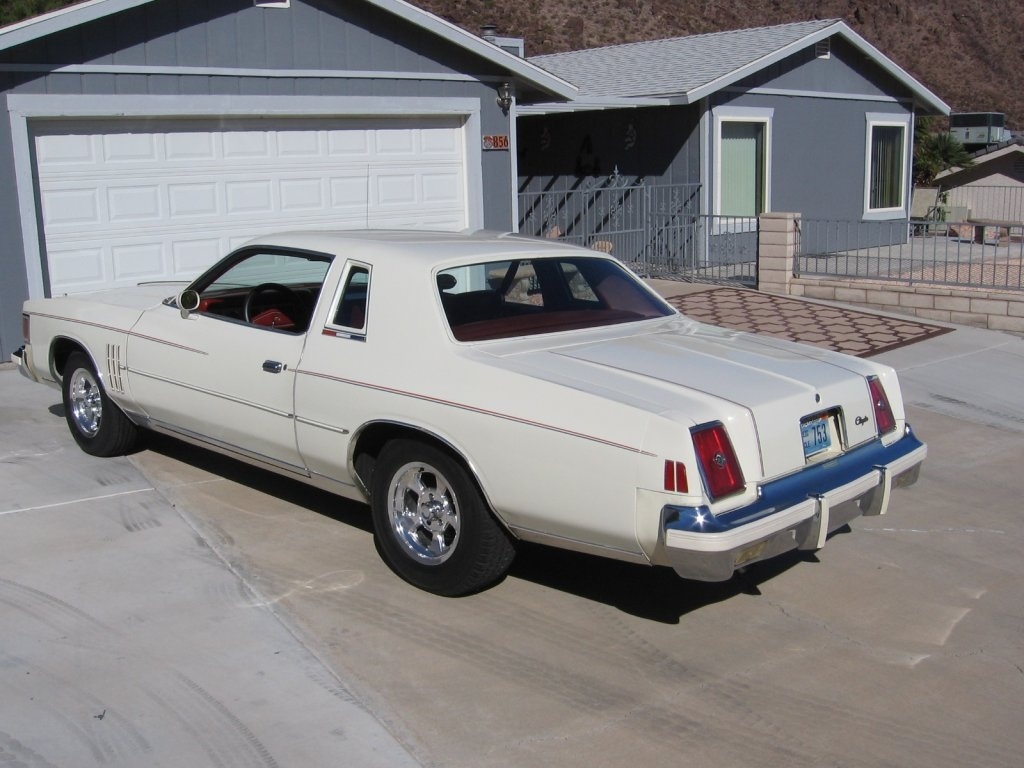

Yes the Ford and Mopar 500's were different. 15X8 x 4 1/2 backspace aftermarket wheels fit no problem. I have 15X7 front and 15X8 on the rear. Jegs brand that work quite well. Plan was to go 15X8 on all four next time it needs tires but that may be awhile.

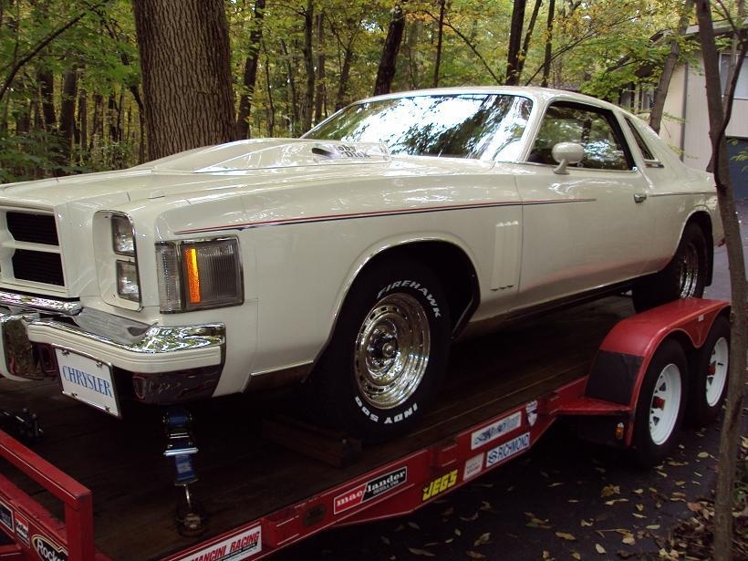

Here is a photo of the 5 on 5 1980 Cordoba wheels.Yes they are hard to come by,,as said above the centers are even harder to find. This photo has a aftermarket center that I have no idea were the guy got them from.

Thanks for the pictures. Your Jegs wheels look really good. I'll check out what they have.

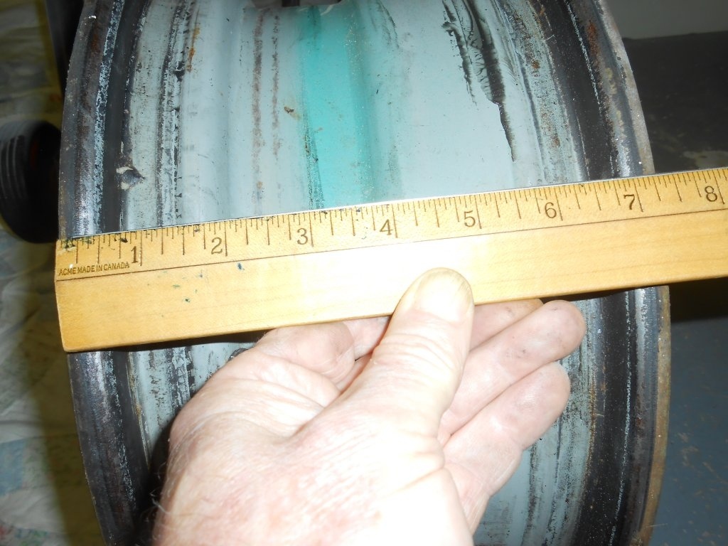

Original 300 wheels are 15X6. I run them on the front of my drag car as they only weigh 13 lbs each with out all the trim - polished.
