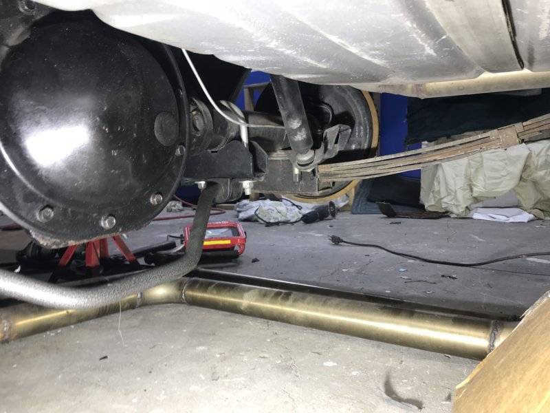

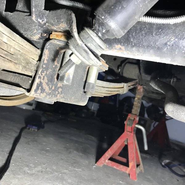

i took the 82 dodge diplomat rear 8 1/4 axle and installed it on my belvedere . I 'm getting a bit of drive line vibration and just getting around to tilting it the right way , with the tremec app from my i phone. I dropped the gear to 3 .55 and bought a new sure grip from Chrysler it was the cheapest place

i used the mounting brackets and made some shims so it would work and bought some new leaf spring pads ( universal ones)
i went to the truck spring shop and bought 1/2 u bolts and drilled out the 7 /16 holes and used the bigger u bolts
i only have the slant six , probably 225 hp now with twin carb set up. so no huge power to make you lose your licence
