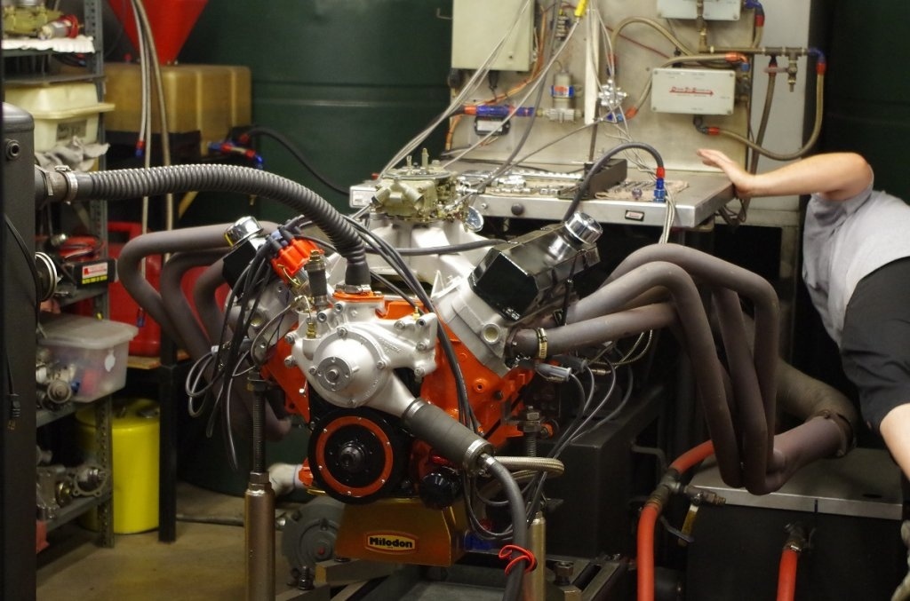

goal is 600hp/tq but realistic 500 crank. Will be limited by intake choices with an n96 hood. Right now I have a street dom which is not that great but its low profile on the rb. Shop is going to port match with the alum heads, we will see how it does. Going to dyno with an 800 avs and 950 holley after break in. Maybe try different intakes?

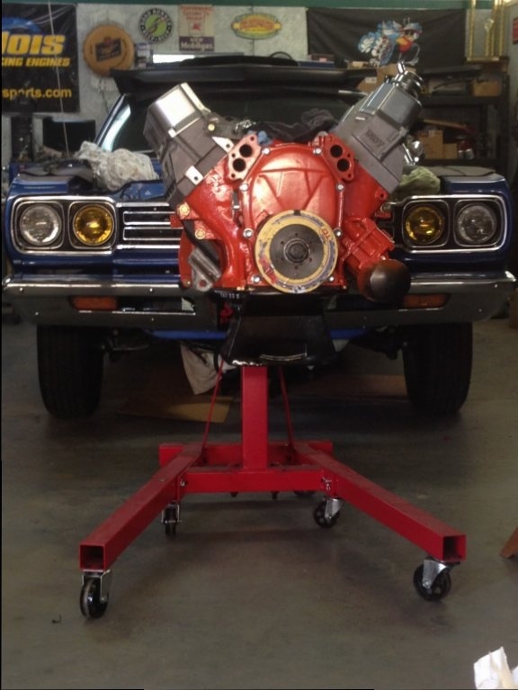

FYI.. i just put a 7 quart Milodon (508 cu in) on my '67 coronet. it does hang down there (actually lower than the TTI headers). I will build a small skid plate to ward off any trash (big bricks) in the middle of the road.
