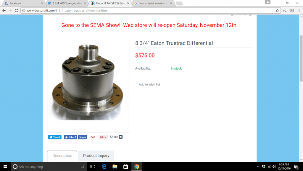

Such as this one from Dr.Diff i'm assuming.. And if I've read right, there is no issue switching to different gears to get a different ratio and completely replacing everything? I'm also planning on getting a crush sleeve eliminator and this will all be going into my '68 Charger.
Thanks!
I switched my 741 case to a Mosier 489 case with 3.55 gears and an Eaton Truetrac. Works great.

That's what I'm thinking about exactly! Just wondered if other people liked them as opposed to other set-ups more.
