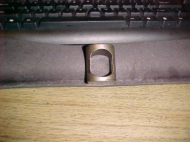

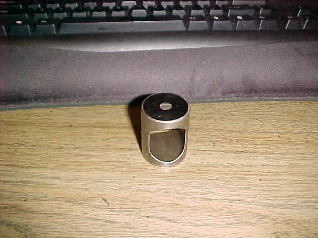

Sure sounds that way.....but there is another fix. Replace the bearings with the Greens. Pull the axles out and shine a bright light into the center and see if it's there or not. The thrust pin for the cone type clutch SureGrip is large diameter while the plate clutch unit is small diameter. One will allow you to easily see light on the other side while the other will show a large nail size hole if they are gone.
Here's what the one for the BW cone type looks like. Once installed, it's in there and can't fall out like the one for the PL can. I don't have a pic for the PL thrust pin but it looks like a big double headed nail and comes apart. The shiny end with the dot in the middle is what the axle faces up with....
