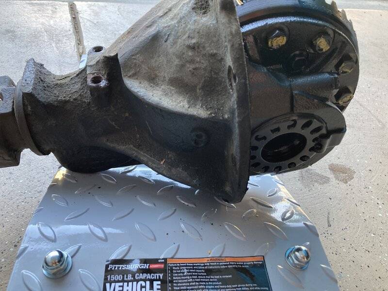

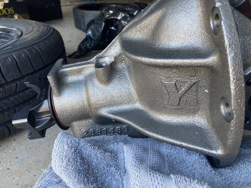

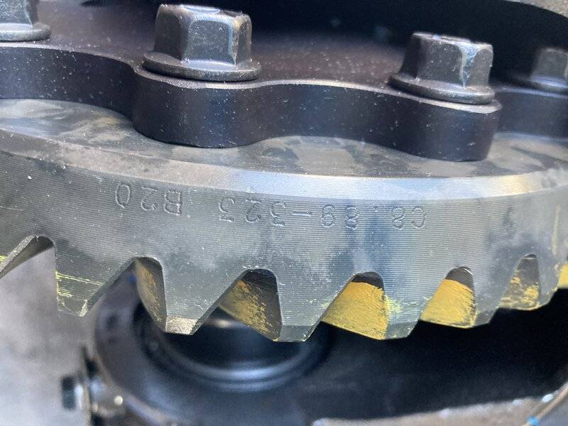

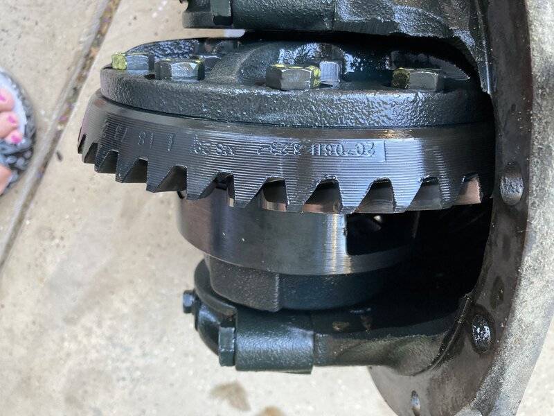

Ok, can't believe it's been a month since I started this thread, but here are some updates. Got the original one out last night and the Dr Diff with Sure-Trac II is ready to go in. The original didn't have too much play but enough that I could rock the yoke a little so it seems like it was ready for refurb. I am wondering if this is the original set of gears...any thoughts are welcome!
View attachment 1284704 View attachment 1284705 View attachment 1284706 View attachment 1284707
Yup, I'd say original gears....and looks like a cone type SureGrip. Uh, don't scrap it. I (and others here) refurb those....
