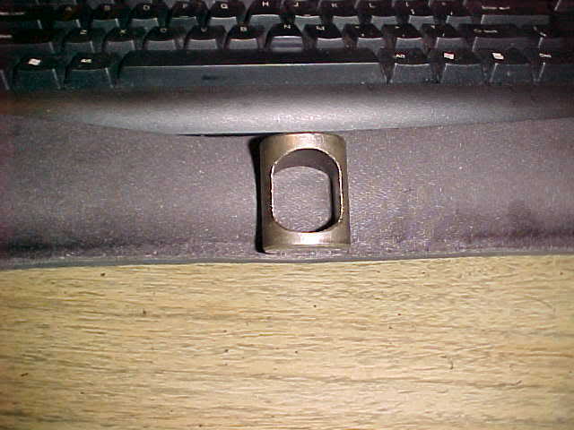

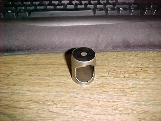

The spider gears cross shaft is what the slot is for in the thrust pin. This one is out of a cone type Sure Grip but the one in the open carrier is similar.
The shiny part is what the end of the axle mates up to. The only way this can come out is if someone took it out or something very wrong happened.
So, I pulled it back apart today. Sure enough, that thrust pin is completely missing. I guess the previous owner had axle problems with green bearings so he just removed it. But how do I get a new one, does someone sell these things? I don't want to have to convert to green bearings just to use these gears.

Oh! If you cant find one I can mail you one
Thanks alot for the offer. I found one locally, but it looks exactly like the one Cranky showed. Are the sure grip and open versions different or the same? I know that 1964 and older open versions were shorter than the later ones. Mine is 1.5" long, but I don't have anything to reference to.

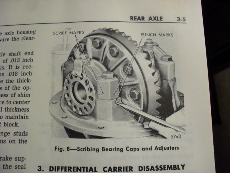

I am going to attempt to replace this myself, but I have never torn apart a differential before. I assume that in order to remove the ring gear that I would need to remove the carrier first. If I mark the adjusters before taking the carrier out, can I just put them back to where they were before and not have any trouble with it? Anything I should know first?
Thanks again.
Don't bother marking the adjusters,mark carrier caps so they go back on same side,remove case then mark ring gear to case position,roll pin will only drive out in one direction toward ring gear side,then drive out pin.Be carful when reinstalling axle and spider gears to align thrust washers exactly before driving in pin.Reinstall ring gear(left hand thread)then case in carrier and set backlash and preload with adjusters.Not too much preload because you have used bearings then.006 to .008 backlash.SAM_1810.jpg
