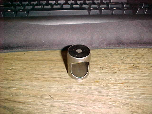

I think its an open diff,,, with two pinion carrier and the pin that floats does not have any type of pin in it to is solid with a slot threw the middle to float on!!! This is where the problem is with removeing it.

This is what the thrust pin/block looks like in a cone type SureGrip or an open diff....and it will not come out without taking the carrier apart. If you have the clutch plate type SureGrip, it's either gone already (like mentioned above) but if not, it will look like two nail heads roll pinned together and you should be able to punch them out without taking the carrier apart.....the ends that are a different color are where the axles butt against.
If it is an open diff, to remove the thrust spacer you will have to remove the carrier from the axle housing.

Yup, I messed up. Open diffs, the cross shaft has to be pulled and the ring gear is in the way...been many moons since working on one of those....
