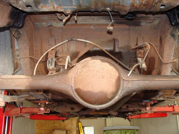

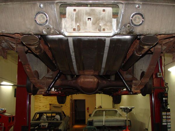

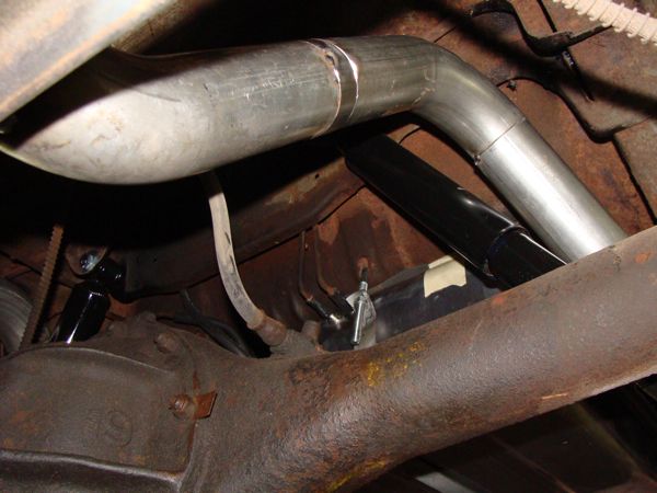

Here are some pics for reference. Someone could have put an 8.25 in your car, but NO B body prior to 65 came with one. All 8.75s have interchangeable third members (the gear set and its housing). The gasket and third member only go in one way so its easy to get the gasket mixed up and it wont line up. These first 3 pics are of the 8.75 in my Roadrunner. The last shot is kinda crappy one in that it barely shows the removable thrid member. The link below is a shot of an 8.25.

The two top studs on the 8 3/4 have a different spacing than the rest of the studs so the gasket only goes on one way.....
