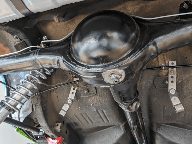

8 3/4 housing drain

I have 1/8" drain plugs in both of my cars for years and have never had an issue. No reinforcement or doubler. So much better than creating a mess, put a small magnet in there if you want to grab metal shavings.
I did the 1/8” drain plug in mine as well, (at the center bottom) when I was installing a new 3rd section. The housing gives plenty of meat to hold the plug. No concern for interference with internals. Wrapped plug with Teflon tape. It just needs to be snugged up - not cranked - to seal. So far, so good.

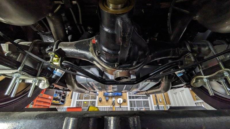

I wanted a drain too, but didn't want to lose the area for jacking purposes. Welded in a section of extra axle tube. Protects the welded in bung and acts as a solid jack point
