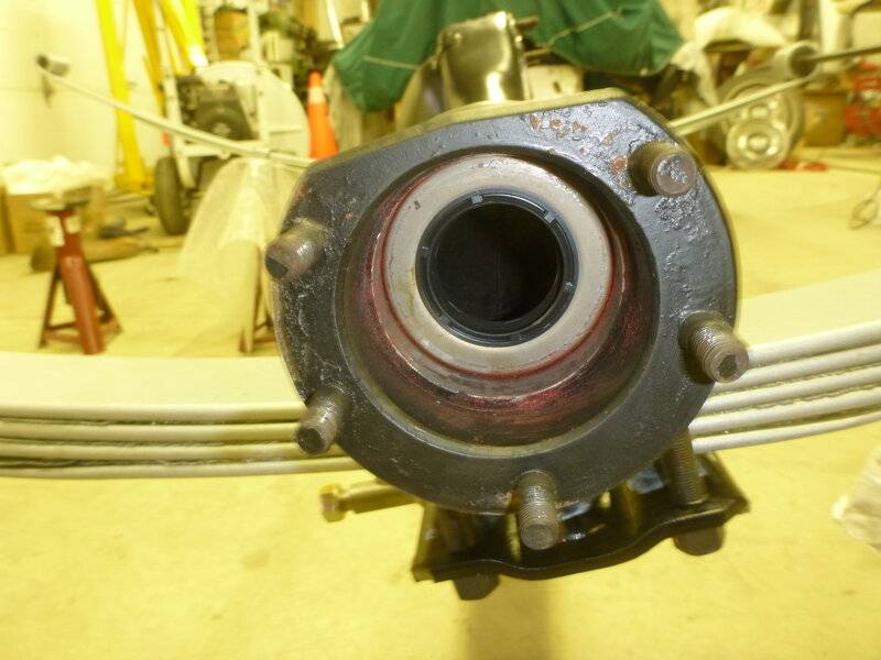

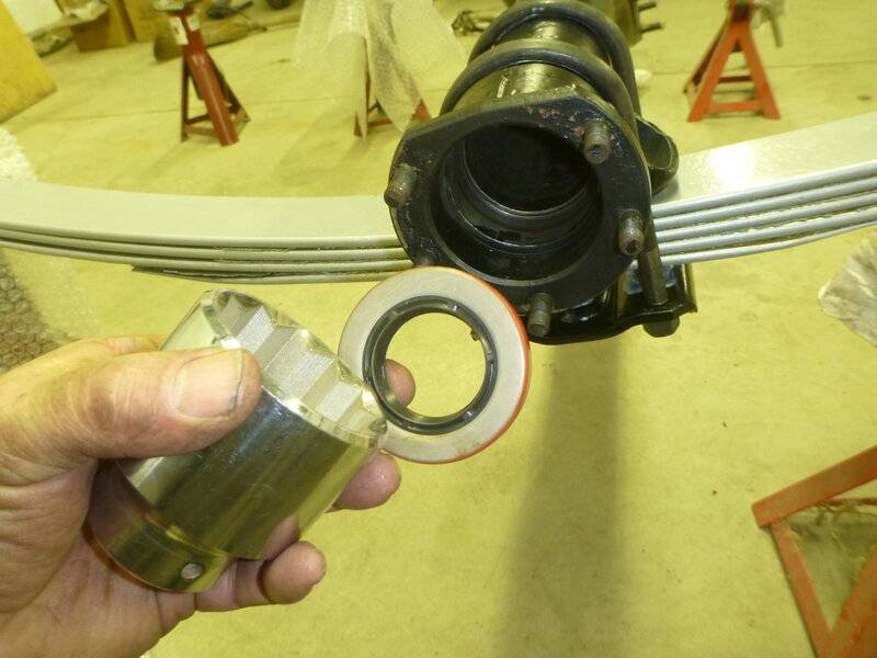

Good day,

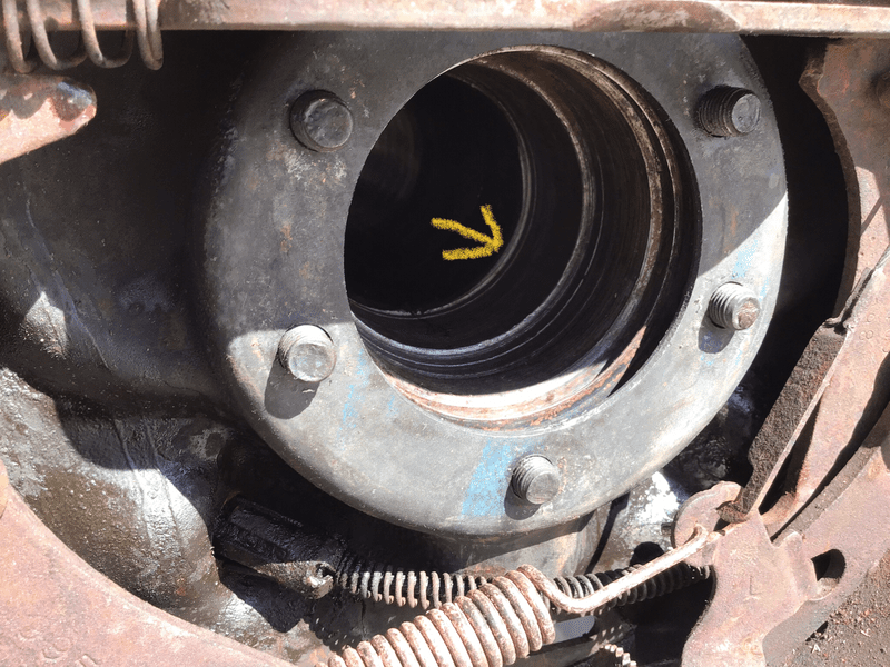

replacing inner axle seals. I did take the measurements before removing. There was about 8mm difference between the sides.
Is the difference normal?
There were no previous leaks. And no obvious groves in the axle.
Should I install the new seals close to the old measurements or should I push them in as far as they will go till they hit the lip?
thanks
macdon221
Yes. There is a ridge/lip.

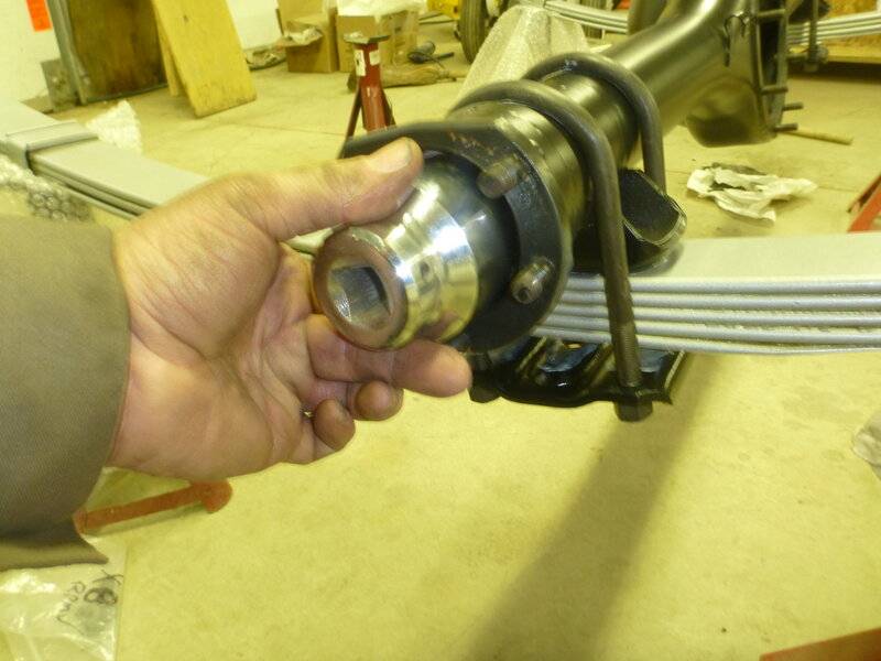

but I read in a few posts that some people are measuring to put back in same spot. Just seemed odd to me as seals normally go pushed into the stop.
They might get stiff and not want to go in any further. Good thing you measured them first. Try it and see.
Drive them in to the step... If you don't drive them in fully it's possible that the bearing retainer ring will make contact with the seal...
One tip, pack the groove on the back side of the seal with grease.... If you don't it's likely the garter spring that applies inward tension on the seal will pop out while your installing the seal..

I just did this job with timken tapered bearings from Dr diff. I totally jacked up one inner seal using a large socket to hammer them in so used a block of wood the size of the axle tube and a dead blow mallet. Drove in nice and easy with wood, and hitting the stop was obvious. I used a HF slide hammer to get the old ones out.
