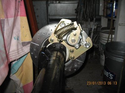

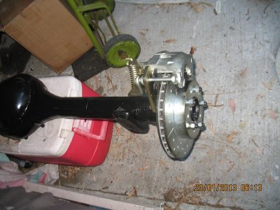

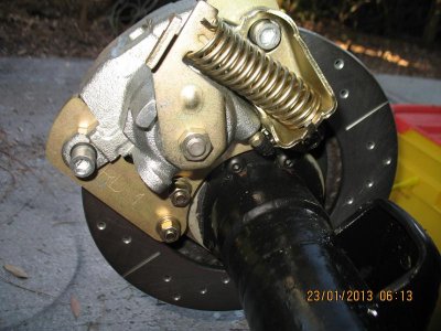

IMG_1372_1.jpgIMG_1370_1.jpgIMG_1371.jpg eldorado calipers and trans am discs. is a true bolt on

i did need to buy shorter bolts for the bracket. ones supplied were 1 1/4" too long. eight bolts . other then that really was super ez with good directions with diagrams written by someone who's native langue is english. wish it was ma mopar but the parking brake was mandatory. sprayed the whole thing with diamond coat, not that anyone else will see it with the steelies. damn thougt i was adding this on to the pics. no delete option?
