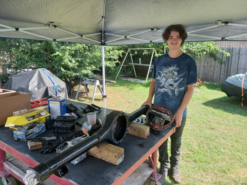

Here is the Kidd with the car as I had it, and his 8 3/4 with his SureGrip:thumbsup:

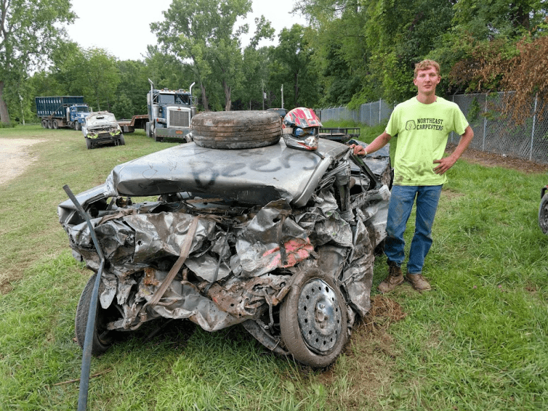

That was a money car.
Started out as a 90 or 91 Buick Park Avenue.
Won 5 straight derby appearances - probably over $2,000 in winnings.
Finally lost on the 6th try running against full size finished 3rd.
I actually found a plug that had come loose and we started it to drive it on the trailer.
But the bottom was so bellied out we had to winch it on.
It was literally 1/2 it's original lenght in that picture.
