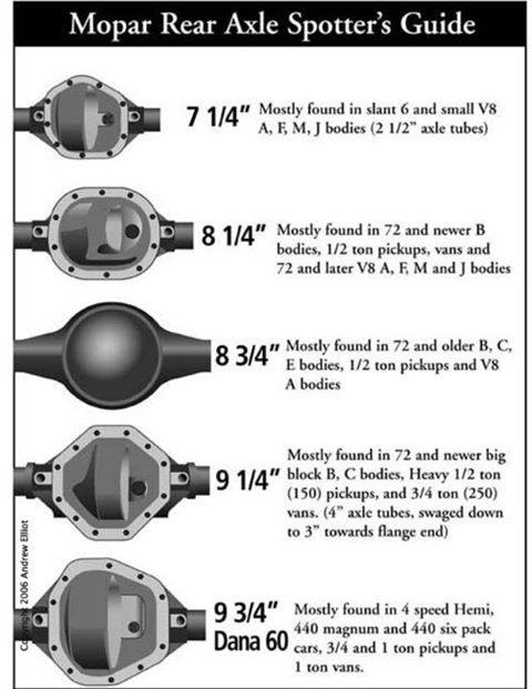

willing to bet you got an 8-1/4 back there now with that 2.71 gear ratio....post a pic to be sure
An 8 3/4 is an 8 3/4. You can put a limited slip unit into it or just change out the whole 3rd member. Does the rear that's in the car have a cover on the back side?

Its a 290 somthing,,gear,, no bolt holes , looks a ford 9inch as in no bolts on back, that is the reason for thepost, everything I read says I couldchange the 3rd to a posi. 355...my dad love him to death,, but damit man his set in his ways,,,8 3/4 would be fine with me if I can get posi, with the right gear,, anyone know where to get one..? 3rd member
Sounds like you have the 8 3/4 rear end. The center carrier is removable. Just pull the axles, drive shaft, and remove the 10 nuts that hold it to the housing and gravity will do the rest. Stay out of the way and put a strong pallet under there. There are 3 carriers, 741, 742 and 489. They all work well unless you are running a hemi. The 489 is the strongest one. I have used all 3 types, and interchanged them in the same housing with no problem. Get a carrier that has the gear ratio you want, and put it in there. The ratio is clearly stamped on the ring gear. You probably want a posi unit. I like the 3.55 posi for most street applications. I took the 2.76 open out of my 69 RR and put in a 3.91 posi, as I take it to the strip some times. Good luck.

Anything can be made to work, but it's a complete different rear end...first, it's metric, second....u-joints are different, then there is the wheel lug pattern, not the same as our cars...brake lines, cables, width of entire housing, spring perches,...I can go on
unless you are building a 1000hp engine, stick with the 8-3/4 gearing...they are very stout and more plentiful than Dana's
