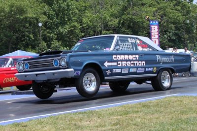

Actually started as a street/strip car then dedicated race only. Cleaned the teeth off a ring gear once on a center section purchased of unknown origin. Switched to Mark Williams 35 spline axles and spool and never looked back. I've back braced the housing, use Caltracs and 10 inch Hoosier slicks. Been running the car like this for 10 years...
This pic was taken a few years ago at Beaver Springs Dragway
Race weight is 3750 and the 540 engine has taken it to 9.88@ 136+

Curious, with that combination of torque, power & weight, how many runs do you get on the ring & pinion? Which gear ratio? 1350 U joints?

This has been in car for 4 seasons approx 65 passes avg. per season. Going to start 5th season in 2015.
3.91 gear ratio Richmond gear not Pro gear.
Yes 1350 yoke.
I do not leave the line at more than 2200 RPM.
Lenny at Ultimate Converter built me a 9 inch that works extremely well at harnessing the torque, allowing 10 inch tires to hook and run 1.37 60 fts as well as great MPH.
