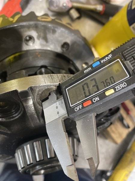

I ordered a set of arp 240-3001 3/8-24 LHT ring gear bolts. I believe it’s a 67 center section. The some shank directly under the bolt head is larger in diameter than the holes in the sure grip half. I see no other bolt in arp catalog. Does any manufacturer make the correct bolt?

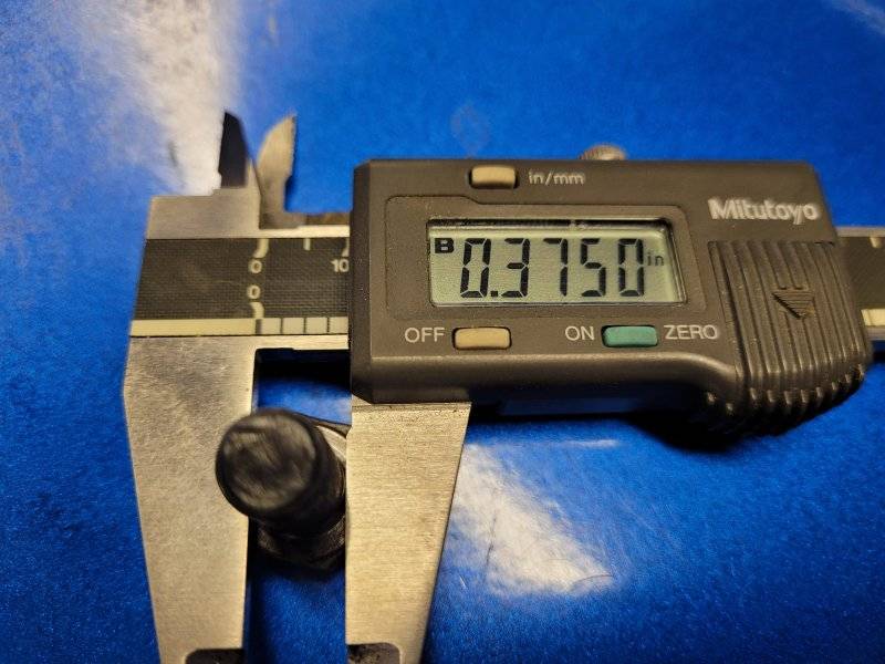

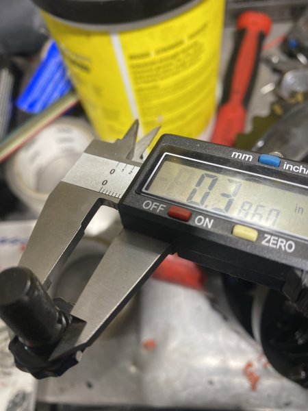

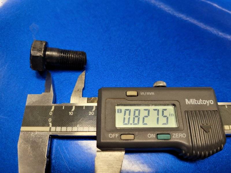

Before you get stupid, I'll go measure the one's that I pulled out of the '64 taper, tomorrow, and see what diameter they are. I scraped the housing and pumpkin / spool. I kept the gears and hardware...
earlier Chrysler carrier units both open and sure grip used a 0.370 shoulder on the ring gear bolts ,, later units starting about 1969 had a 0.380 shoulder on the ring gear bolts which would not allow them to be used on the earlier units ,, all you have to do is simply open your ring gear bolt holes up to 0.390 with the right size drill bit and you will be good to go. just secure the carrier properly and drill thru. as stated all the after market sure grip units use the 0.380 shoulder bolts. Ratech Manufacturing who make and sell kits to rebuild differentials includes a note in their 8-3/4 kits to open up the holes in the earlier carriers so the bolts in the kit will work.
